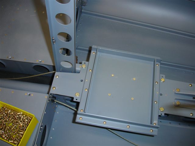

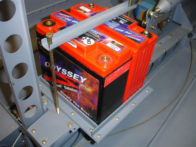

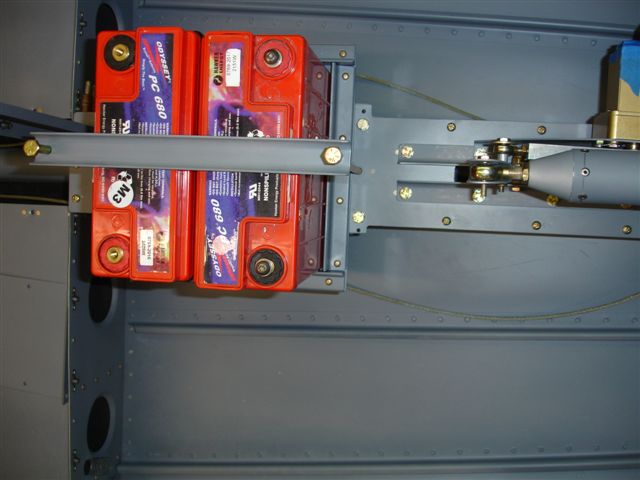

PostPosted: Wed Aug 15, 2007 5:47 pm    Post subject: Re: Battery Tray for a pair of Odyssey 680s Reply with quote
Here's the way I did it...
Zack

 Filesize:  53.12 KB
 Viewed:  432 Time(s)
 Filesize:  68.53 KB
 Viewed:  423 Time(s)
 Filesize:  44.46 KB
 Viewed:  376 Time(s)
