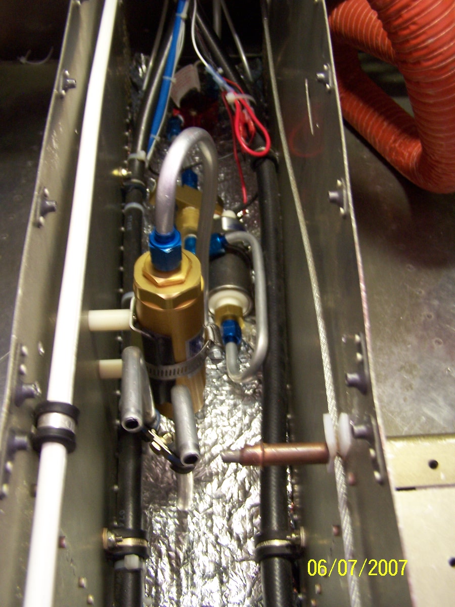

I was wondering if anyone has any tricks/tips on cleaning the standard fuel
filter in the tunnel. Primarily how to remove it without dumping fuel and
the best way to clean it.

Just run the engine and then turn the fuel selector off and wait for the engine to quit. Then fold up about 6 or so paper towels and place then under the connections of the fuel filter, then simply remove the filter. It is not a tough job, just a pain taking off all the screws to get at the tunnel, but then you have to do it anyway to see the rest of the stuff anyway. I had lint mostly in my filter. Very easy to clean and re-install.

I mounted my fuel filter vertical. I used this same installation on my RV8 and it work great. The fuel filter is removed from the top. I shut off the fuel valve before removal and no spills.
Greg...
