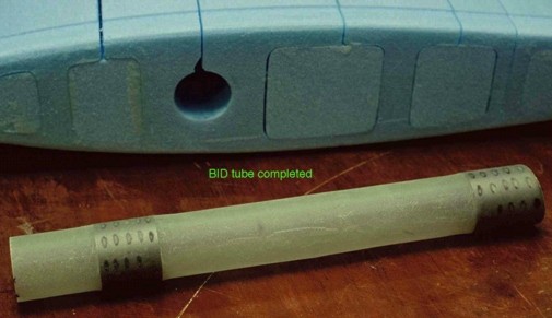

PostPosted: Wed Jul 25, 2007 3:04 pm    Post subject: 10672 Reply with quote
Hi! Neils I patched the mod in direct . It can only be done during build and links the two tailplane bushes. Regards Bob harrison. Improved TP5 and TP6 Sleeve Retention
Ownership
Europa Club
Rickard Rating
Simple Mod
PFA Mod #
10672
Purpose
Reduce the risk of the torque-tube sleeves becoming disbonded from the tailplane, and the inside of the tailplane being damaged during fitting or storage
Description
Instructions for creating a bid tube surrounding the TP5 and TP6 torque-tube sleeves and bonding the sleeve into the TP2 foam and to the inboard and outboard tailplane ribs
Contact
Europa Club Membership Secretary
Details
(members only)
PDF
Photos: Enlarging hole, newspaper applied, laying up, cutting film, tube completed, rib completed, installed
