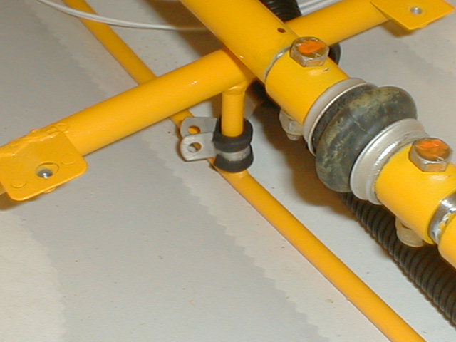

PostPosted: Wed Jul 18, 2007 10:23 am    Post subject: Re: Mushy control stick Reply with quote
here is the U-Joint.
 Filesize:  53.83 KB
 Viewed:  835 Time(s)
Paul Petty
Kolbra #12
Ms Dixie
912 UL 70" warp
Thom Riddle
Posts: 1597
PostPosted: Wed Jul 18, 2007 10:43 am    Post subject: Re: Mushy control stick Reply with quote
The photo of that "rubber u-joint" looks to me like a regular u-joint with a rubber dust/dirt cover. I'll give you good odds that the connection is NOT rubber.
Some 25 or so years ago when I was doing machine design work, we would sometimes use a "rubber" flexible coupling but they were not designed to correct for an angular mis-alignment like this one is obviously doing. The rubber flexible coupling was intended to compensate for very slight axial mis-alignment and prevent transmission of source vibrations throughout the system.

PostPosted: Wed Jul 18, 2007 10:57 am    Post subject: Re: Mushy control stick Reply with quote
Thom,
I never really thought about it nor looked at it that much. What you say makes sence tho thanks!

PostPosted: Wed Jul 18, 2007 11:02 am    Post subject: Re: Mushy control stick Reply with quote
wow! never knew there was a tiny U-Joint in there. Looked them up in AC spruce.

PostPosted: Wed Jul 18, 2007 11:11 am    Post subject: Mushy control stick Reply with quote
| Paul Petty
That is a rubber dust cover, not a rubber universal joint.
