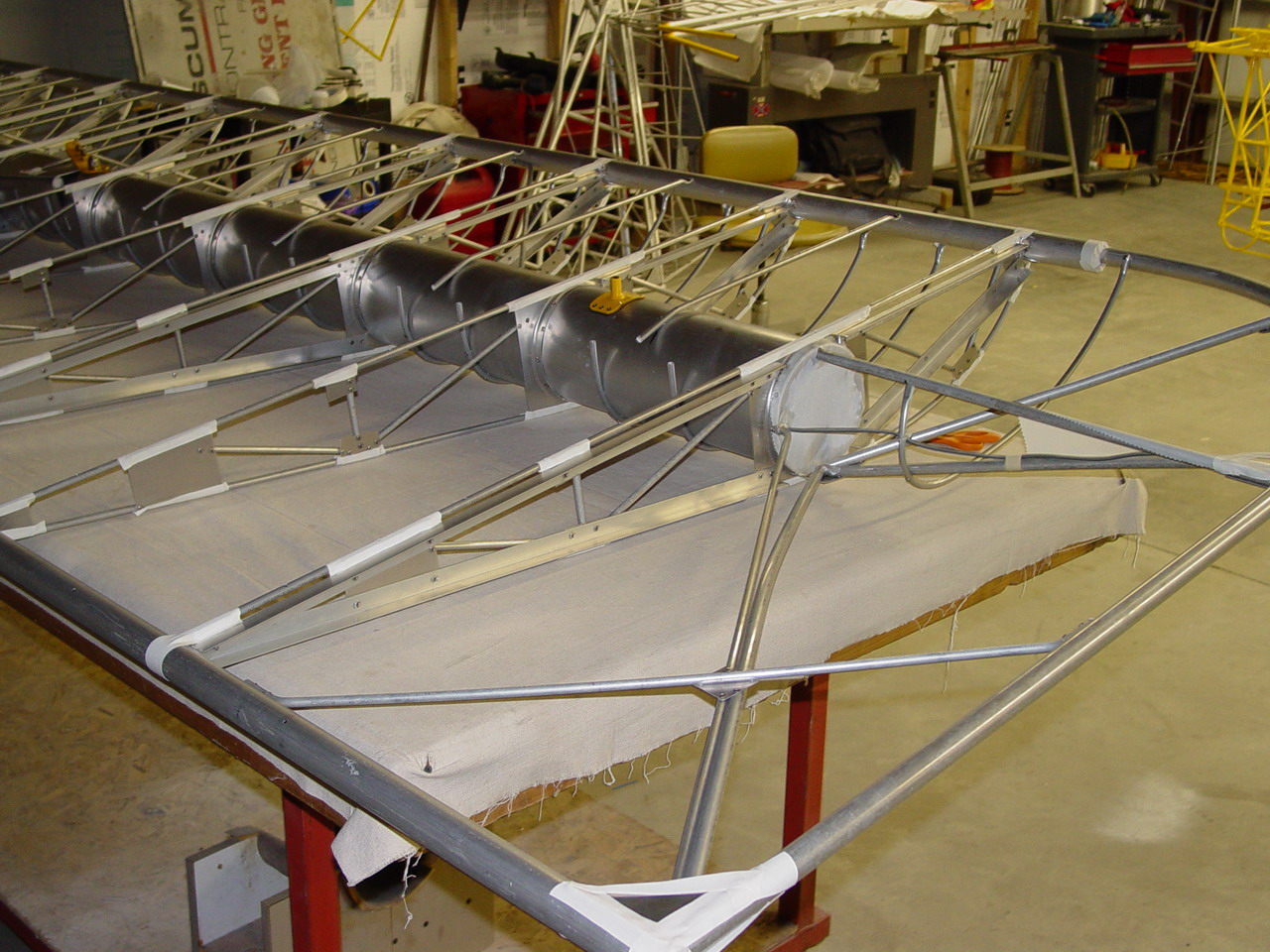

I have thought quite a bit about the wingtip vorticies affecting spades on the tips, and I have come to concusion that I have no idea I think the only way I will ever know is to try it. I will bolt the spades onto the counterweights so that I can take them off if I dont like the results. Threre is a possibility of the ailerons going hard over if the spades are to big or the vorticies are a big probelm, so I will start out with small ones to see how they act and make them bigger until the releive enough of ths stick pressure. I will also flight test it by flying a foot off the runway and progressively faster speeds to get an idea of what they will do.
Lucien,
The aileron forces on the MK III Xtra are very heavy, much heavier than on a Cessna 172. I could live with even normal forces, but not the very heavy forces needed to make a turn. The Kolb is not designed to roll fast, and I dont want it to, but I do want to be able to turn the plane without a huge amount of effort. I have thought about wing twist and fatigue of the panels, and I plan to fly the plane within its limits, I just want it to be pleasant and easy to fly. Durring the building phase, I got some good advice from John Hauck and streingthened the wing structure with angle aluminum along the ribs, before and behind the spar. This should make my MK III much more resistant to any fatigue and twisting from aileron forces. Attached is a picture of the wing before covering.
Reflexing the ailerons might reduce the aileron forces some, but it is a horrible way to do it. The proper term for reflexed ailerons is "Spoilerons", meaning the ailerons are also acting as spoilers. It may make it a bit easier to roll, but relfexing the ailerons also kills lift, increases stall speed, and makes the wing less efficient. I dont want any of these bad side effects in my plane.
Michael Bigelow

Joined: 09 Jan 2006 Posts: 4639 Location: Titus, Alabama (hauck's holler)
Posted: Wed Jul 18, 2007 9:01 am Post subject: Mushy control stick |
Mike:
The weakest, most flexible part of the Kolb wing is the bow tip. You
plan on turning the aileron counterbalance weight into a spade at the
weakest, most flexible point, outboard of the wing tip. Might want to
think on that a bit. Also, the counterbalance weight attachment was
not designed nor intended to have increased torsional loads.
Remember, every time you change one thing, it will affect several more
in the chain.
If it were me, I would look at the geometry of the aileron control
from stick to aileron. To get a little more, or a lot more mechanical
advantage, it is pretty simple to change the arm length of a bell
crank or horn to more effect with less effort.
All Kolbs inherently load up the ailerons at speeds over 50 to 60 mph.
You ain't gonna change that unless you cut the cord of the aileron in
half. Then you lose low speed aileron authority which, to me, is
extremely important. Much more important than light stick force at
higher speeds. At lower speeds it is easy to move the stick from stop
to stop, when it is really needed should you get caught in violent
winds and want to be on the ground more than in the air.
At higher speeds one does not have to deflect the aileron but a tad to
make the aircraft roll. A little rudder input helps. Also a little
patience. Like has been said, you ain't flying a Pitts Special.
If you are interested in doing snap rolls and aileron rolls then you
might need a whole buncha aileron at higher speeds.
Kolbs are not to be compared with Cessna 172's, Piper Warriors,
Challengers, Titan Tornados, ect. They have very little in common.
Kolbs do things differently than most airplanes. Yet, they are very
easy to fly and very forgiving, if you don't turn into a design
engineer and screw it up.
