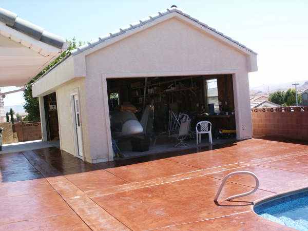

BTW. My shop and pool I have been building are virtually finished. All
that's left on my shop is the doors I am going to make. Here's a photo with
my MkIII and the GlaStar.

Very nice Mike
steve
