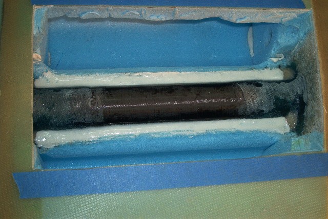

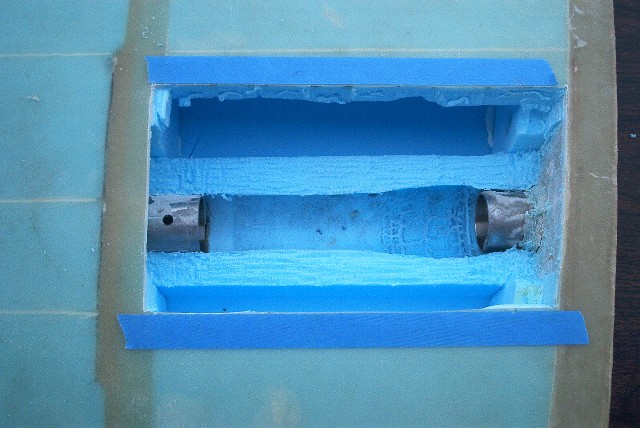

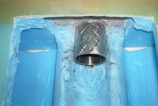

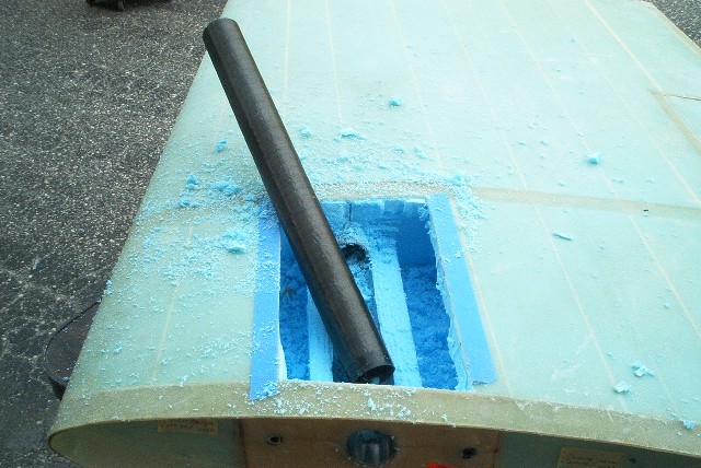

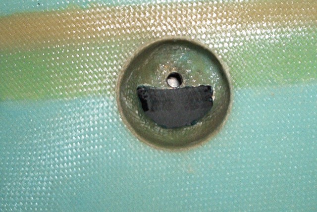

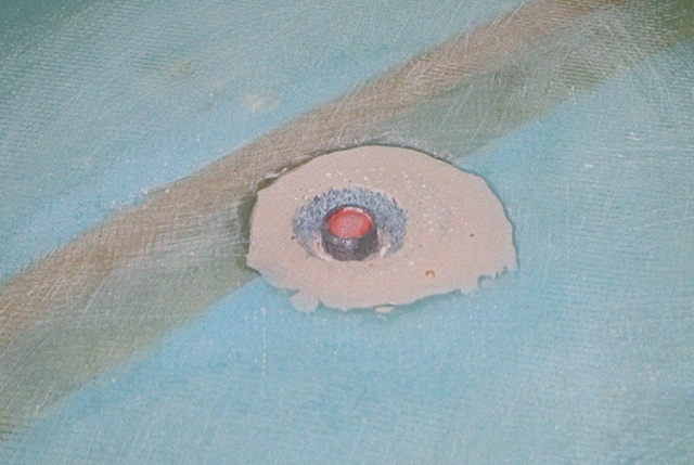

Our accelerated stabilators had one of the inner bushings debond the first
time fitting the TT.
We took the "Europa Mutilation" route, went at the bushings from the
bottom, cut grooves and rough sanded, first ply was Redux/BID and
Redux/Flox covered in peel ply, and subsequent layers Aeropoxy.
I garbage picked a thin wall Carbon Fiber oar from a rowing skull and
connected the 2 bushings. Same procedure, Redux first ply, then Aeropoxy.
My outer bushing got drilled right through the bottom by the accelerator
with the oversize drill used for drain, thus the pip pin would not grab.
Lakeland sent me next size pip pins, but I canned the whole idea of pip
pins. I am using solid stainless cap head Allen shoulder screws
(www.mcmaster.com type in stainless shoulder screws, then socket). I
turned a threaded base which I knurled and got it stuck when reinforcing
the outer bushing joint.
For the top, I turned a smooth ID wall cup knurled on the OD, just large
enough to accept 2 seals and got it stuck. The top receptacle and bottom
threaded base is stuck well, in event the outer bushing debonded, this
would hold the stabilators in place.
I have no drain on bottom, just can see the head of cap screw that is
flush with stabilator. The 2 seals I am certain would prevent the screws
from ever backing out (also from water ingress), but I installed mini ball
nose plunger to catch a grove on the screw (incorporated in the top
receptacle)
Ron Parigoris

PostPosted: Wed Jun 20, 2007 9:02 pm    Post subject: EUROPA PIP-PIN RECESS Reply with quote
Ron,
Looks like you've come up with a resourceful solution to a nasty
problem. Do you have any additional pixs to illustrate your fix?
Fred

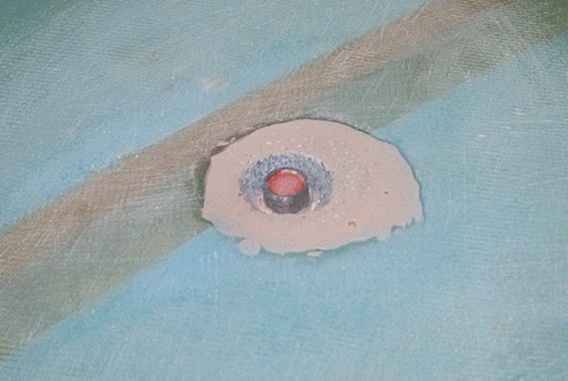

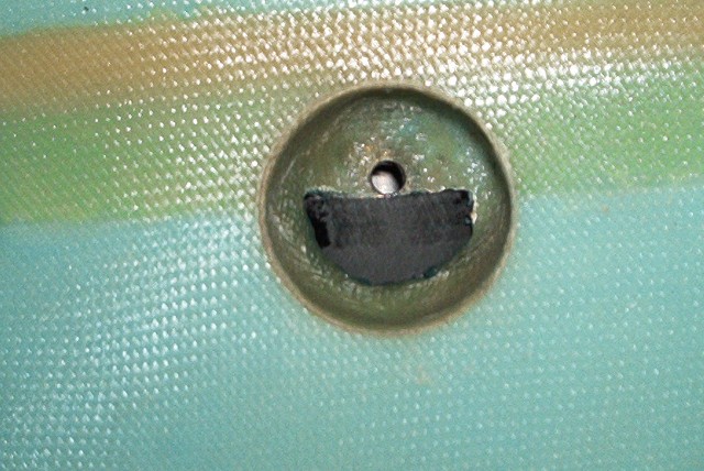

A few more 1 of 2.
Ron Parigoris
 Filesize:  97.27 KB
 Viewed:  446 Time(s)
 Filesize:  92.68 KB
 Viewed:  385 Time(s)
rparigor(at)suffolk.lib.n
PostPosted: Wed Jun 20, 2007 9:26 pm    Post subject: EUROPA PIP-PIN RECESS Reply with quote
Hello Fred
"Do you have any additional pixs to illustrate your fix?"
A few more 2 of 2.
Ron Parigoris
 Filesize:  96.7 KB
 Viewed:  428 Time(s)
 Filesize:  90.29 KB
 Viewed:  407 Time(s)

fklein(at)orcasonline.com
PostPosted: Wed Jun 20, 2007 10:38 pm    Post subject: EUROPA PIP-PIN RECESS Reply with quote
Ron...a picture's worth 1000 words...thanks, and I need a few more
words:
I take it the shoulder of the screws is what penetrates the TT and
bushes, and both the CF tube and the embedded and threaded "base" you
turned help to keep the outer bush bonded in place.
Hey...it's gotta be late in NYC...go to bed! Smile
Fred
