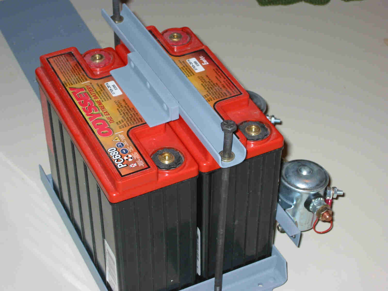

Any chance of getting a pic of your battery tray mod?

Attached is my approach and I sent a series of pictures offline so as
not to clutter up the list (I think they've been posted before).
Essentially I took the easy way out and just widened the stock tray on
the non-contactor side and moved the aft angle forward a bit. I have
both contactors mounted on a piece of angle that's bolted into the stock
contactor location.
Bob #40105
