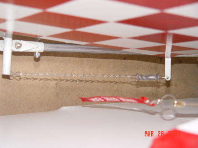

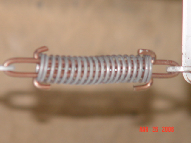

I made my compression springs...
a couple of springs , and a little welding wire....
Gotta Fly...
