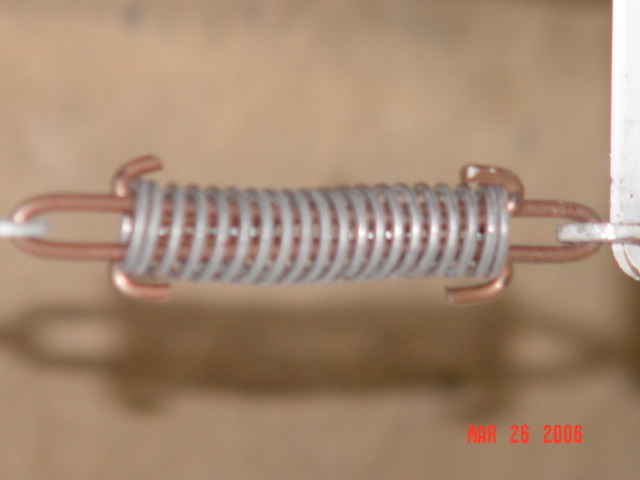

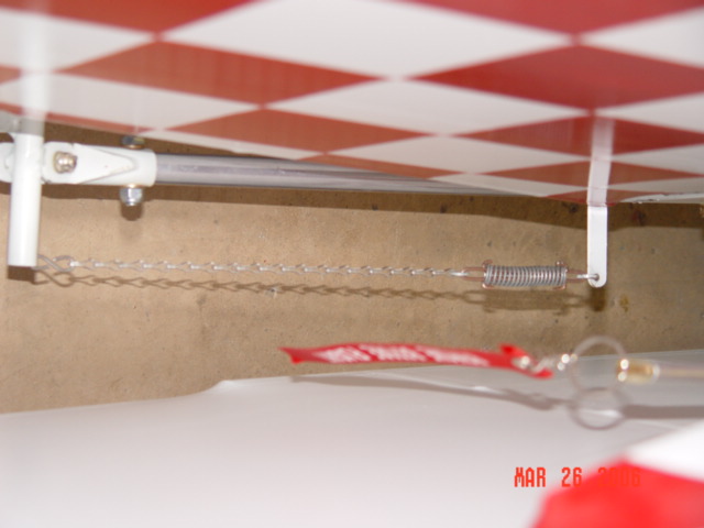

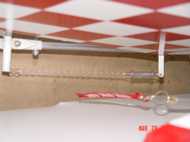

Posted: Thu Jun 14, 2007 1:25 pm Post subject: Re: FireFly Tailwheel Spring Failure |
I made my compression springs...
a couple of springs , and a little welding wire....
Gotta Fly...
Mike & "Jaz" in MN
