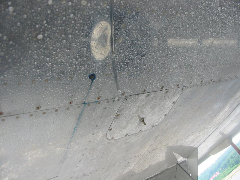

I know we just had this discussion about a leaky rivet on a fuel tank. I didn't comment because I thought I was the lucky recipient of leak-free quickbuild tanks. You'll notice from the attached photo that I was not. Seeing that did not make me happy.
Last August I pressure tested my tanks using a pressure gauge from a blood pressure cuff before installing them. I pumped them up to 35 mmHG (~ 0.67 psi) and left them for 2-3 days. The pressure did not change so I figured they were good. After filling them I checked for leaks and didn't see any. I've had fuel in the tanks for 10 months and flown 85 hours. As I was washing the bugs off my wing yesterday I found this leak. I'm glad I found it before painting.
I plan on emptying the fuel from the wing and trying the Locktite 290 approach, unless someone has a better suggestion.
-Jim

You are lucky that it is only leaking from the rivet.  Mine QB leaked in several places resulting in much debates, head scratching and a big hole on the rear of the tank to do repairs.
The 290 WILL work.  My rivet leak has held up for a year now.  I would put the same amount of neg. pressure on the tank while applying the 290 and let them sit overnight.
