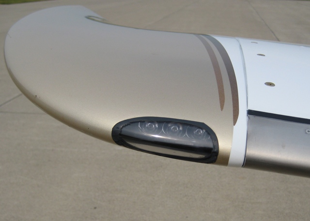

rtitsworth
Joined: 16 Jan 2006 Posts: 76 Location: Detroit, Mi
Posted: Wed Jun 06, 2007 5:09 am Post subject: wig wag HID lights |
[quote] --
| | - The Matronics AeroElectric-List Email Forum - | | | Use the List Feature Navigator to browse the many List utilities available such as the Email Subscriptions page, Archive Search & Download, 7-Day Browse, Chat, FAQ, Photoshare, and much more:
http://www.matronics.com/Navigator?AeroElectric-List |
| Description: |
| Filesize: |
77.96 KB |
| Viewed: |
785 Time(s) |
