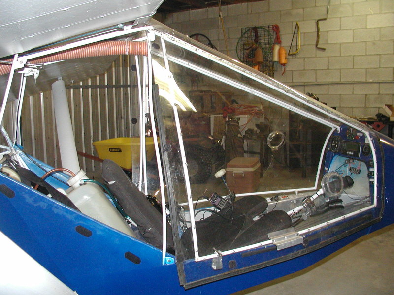

PostPosted: Mon May 28, 2007 11:33 am    Post subject: flight to MV-Larry C. Reply with quote
Hi,
After flying better than 2000 miles with the enclosure on the rear on the trip, I am positive it wasn't a fluke. You see when John H and W as well as Roger got here, we put in better than 6 hours flying all over the area here. Head and tail winds of course mixed. My ground speeds were 6 to 8 mph faster, and the temps were still reasonable inside with the heater on, since the air seems to be pulled back into the cone of the enclosure. I know that I can smell gas when I refuel while I fly. If it were me and I decided that I wanted a rear enclosure, I would make a serious effort to keep it as clean and aerodynamic as possible, every thing tapered to the rear, including the area at the rear of the cage. I would still do a before and after test to see if it was worth it. The picture shows how the front enclosure looks.
Larry, Oregon
[img]cid:002b01c7a15e(at)usermj5tjr71vq[/img]
 Filesize:  135.62 KB
 Viewed:  284 Time(s)
