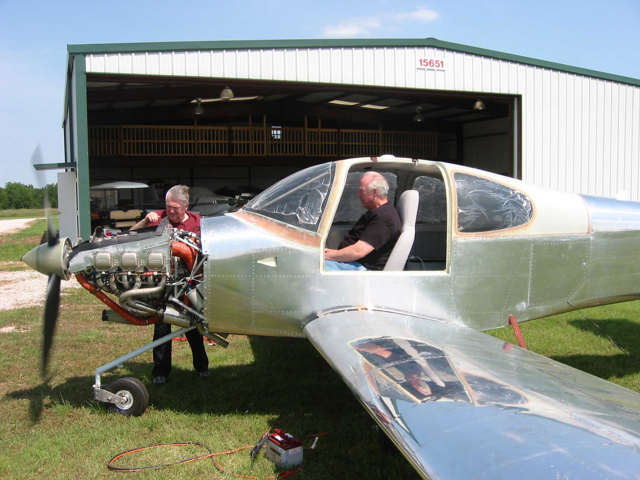

There comes a time with every builder when he or she hears someone deep inside the hangar say "Gentlemen start your engine" :>} and today was that day for me. I was able to roll the plane out of the hangar and fired this bird up. There were a few small glitch's, like you've got to remember to turn on the fuel value :>}
I had trouble with my EI engine monitor going off line each time I tried to start the engine. We ended up putting an analog gauge on the engine for oil pressure and forged on. The EI unit has a know problem that when there is a voltage drop, like starting the engine, the unit shuts down. But as soon as the engine starts it comes back on line. I have to send the unit in for an update to it to fix the problem. The RPM was also acting goofy. Hell at one point I got 3800 RPM. This problem was to do with the Lazar system emitting to much interference and they are sending me out a noise filtering unit to fix that problem.
We had to adjust the mixture and idle a couple of times, luckily for me a neighbor on the field and a good friend is great with engines so he saved my bacon.
One other problem I ran into was that my battery wouldn't turn over the engine enough to start it so we had to jump start it with battery cables. I'm overnight charging the battery but I think the battery is either going or already gone to battery heaven. It's a new Odyssey battery !
Anyway I thought I would report my progress. I've attached a couple of pictures for your perusal.
Small RV grin in place right now with a bigger one hopefully to follow shortly :>}

Just a reminder to anyone using Odyssey style batteries, they do not like being run flat. Check them every couple months to make sure they are topped off and if you are using them for testing I would recommend keeping a charger on them to make sure they are full. They keep their charge exceedingly well when in storage but they still need to be checked. If you run them flat they are basically a paperweight.

Congrats. My UBG16 manual specifically requires it to be off during
start. Only takes it about 5 secs to boot up when I switch it on.

At the risk of starting a battery brand war, I would like to offer an alternative to Odessey.
I have been using Sears handicap battery for 15 years in my planes. This battery, combined with a L model Skytech starter, will crank your IO540 for ever (especially when you have trouble with Hot Starts). I have actually never seen the end of the life on this battery, I just replace it every three years as a precaution. This battery costs less, lasts longer, It is available to pick up 7 days a week and if you let it go flat, you just recharge it. Another bonus is that it fits the existing battery tray in all RVs without any modifications.
I have seen enough neighbors with Odessey batteries laying on shelf as "Paper Weight".

[Jesse Saint] This is a great time to mention the settings on the RPM gauge on anybody’s engine monitor. We have had times that it read way low and we couldn’t figure out why it wasn’t getting full power and then realized that the sensor setting on the EMS was not correct. Before changing anything with the Prop Governor or engine, get a visual tach, point it at the prop and see what you are getting. That can help avoid big problems. Of course, if you are reading higher than you are spinning, then it is not necessarily as dangerous, but you still want to fix the reading before you start adjusting. On the engine monitor, if the option is available to have a backup battery, that is always a good way to go so you can have it on when you start. I run my EFIS/EMS as the only instrument that comes on with the master so it will be on for starting.
