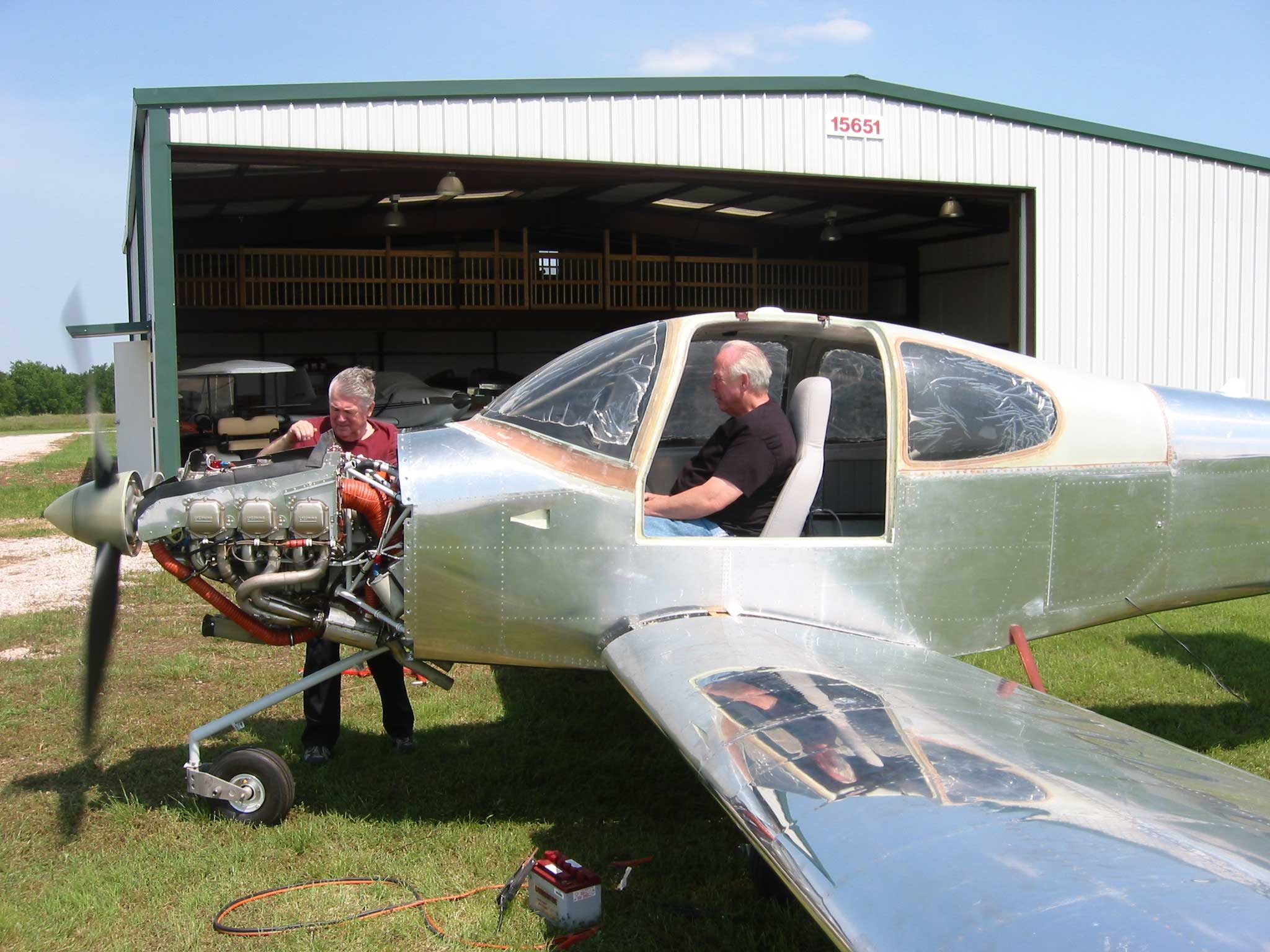

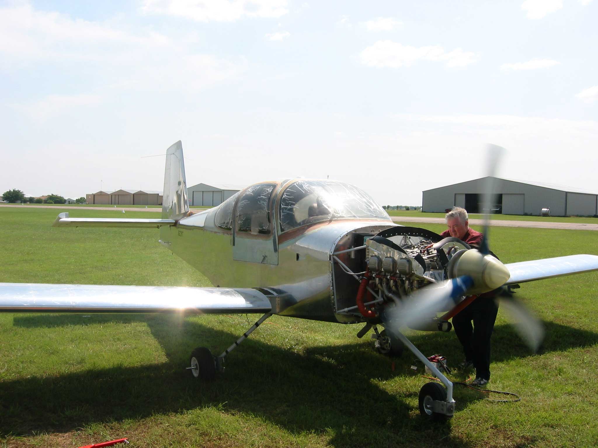

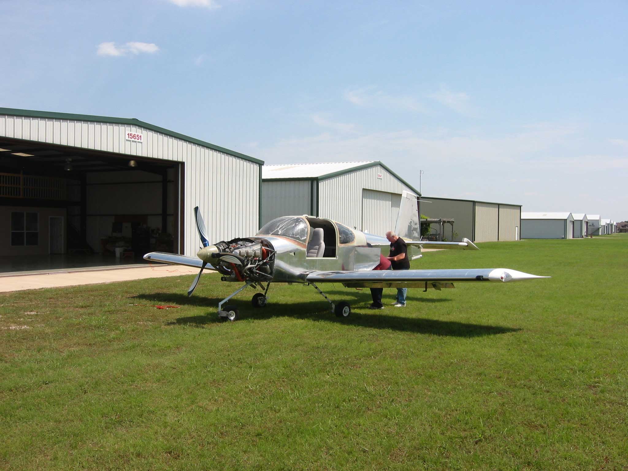

There comes a time with every builder when he or she hears someone deep inside the hangar say "Gentlemen start your engine" :>} and today was that day for me. I was able to roll the plane out of the hangar and fired this bird up. There were a few small glitch's, like you've got to remember to turn on the fuel value :>}
I had trouble with my EI engine monitor going off line each time I tried to start the engine. We ended up putting an analog gauge on the engine for oil pressure and forged on. The EI unit has a know problem that when there is a voltage drop, like starting the engine, the unit shuts down. But as soon as the engine starts it comes back on line. I have to send the unit in for an update to it to fix the problem. The RPM was also acting goofy. Hell at one point I got 3800 RPM. This problem was to do with the Lazar system emitting to much interference and they are sending me out a noise filtering unit to fix that problem.
We had to adjust the mixture and idle a couple of times, luckily for me a neighbor on the field and a good friend is great with engines so he saved my bacon.
One other problem I ran into was that my battery wouldn't turn over the engine enough to start it so we had to jump start it with battery cables. I'm overnight charging the battery but I think the battery is either going or already gone to battery heaven. It's a new Odyssey battery !
Anyway I thought I would report my progress. I've attached a couple of pictures for your perusal.
Small RV grin in place right now with a bigger one hopefully to follow shortly :>}
