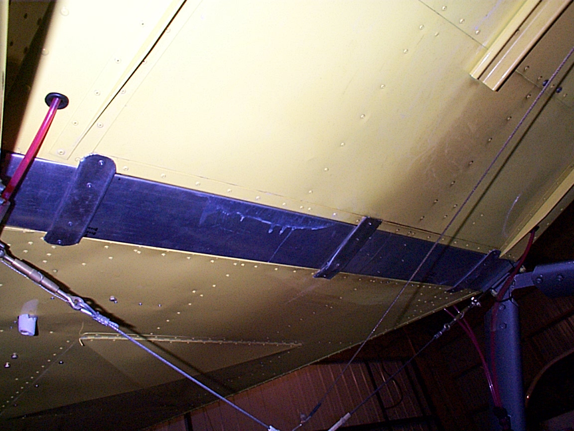

The instructions are on www.stolspeed.com . I like the VG's they sell and will buy a set for my Rans S 7 next fall when I go back to Florida.
For the 701 it's extra easy. Just measure 130mm in front of the top edge of the nose skin where it rivets onto the spar - this will be the front tip of the VG. For under the horizontal stab measure 100mm in front of the gap between stab and elevator. I've posted the photo of the gap cover.
Have Fun.
Tom Schulke
