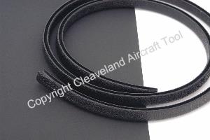

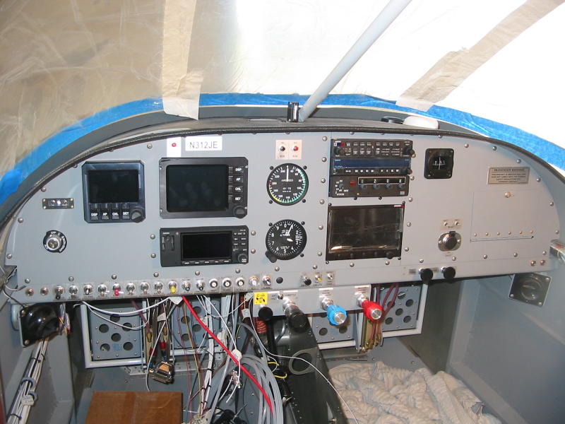

I bought Glare Shield vinyl and Glare Shield edge trim from Cleveland Aircraft Tool. http://www.cleavelandtoolstore.com/ The black vinyl has a dull finish which does not reflect the sun glare. I glued it down with 3M Super 77 and finished the exposed edges (around hand holds and defrost fan) with black Sikaflex. Pictures attached.
