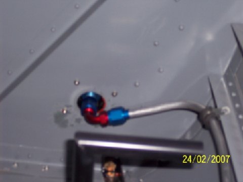

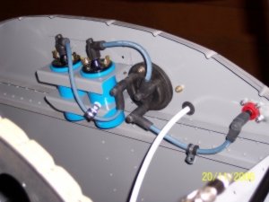

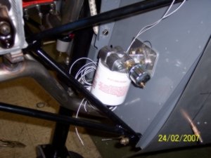

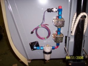

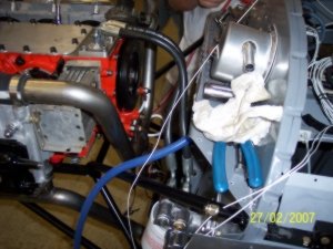

naumuk(at)alltel.net Guest
Posted: Thu Apr 12, 2007 5:24 pm Post subject: Corvair firewall |
Mark-
This is the answer to what I have been looking for. As you can see, I want to get this into the Matronics archives. Thanks.
Bill Naumuk
HDS Fuse/Corvair
Townville, Pa

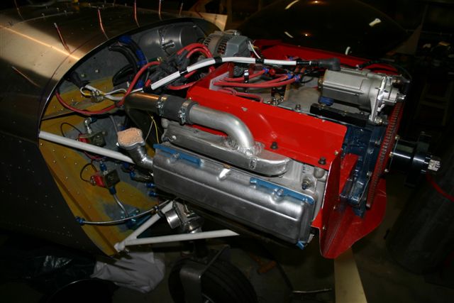

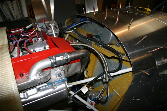

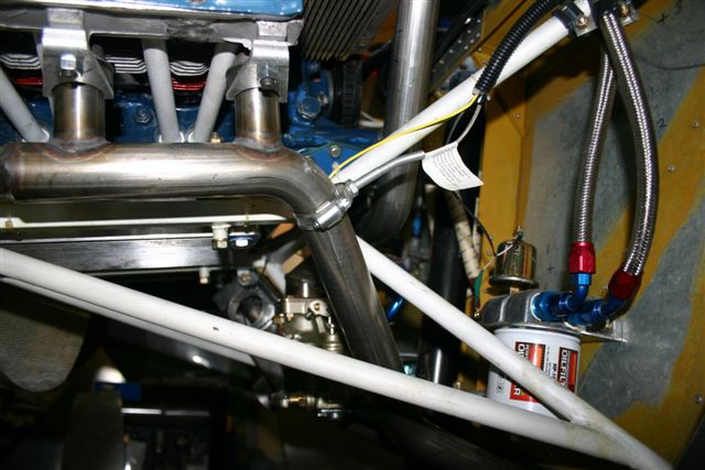

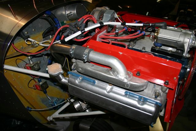

Afterfxllc(at)aol.com Guest
Posted: Wed Apr 25, 2007 5:45 pm Post subject: Corvair Firewall |
I have a complete FWF finished and can give you any information and measurements you need. here are some pics.
