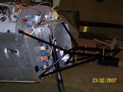

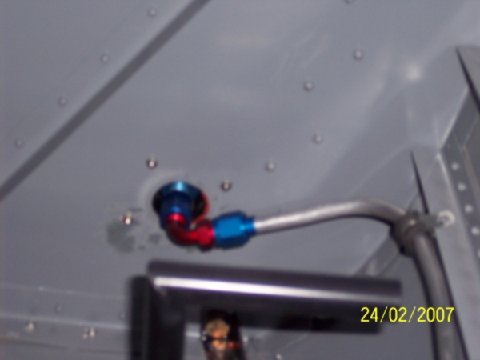

naumuk(at)alltel.net
PostPosted: Thu Apr 12, 2007 5:24 pm    Post subject: Corvair firewall Reply with quote
Mark-
This is the answer to what I have been looking for. As you can see, I want to get this into the Matronics archives. Thanks.

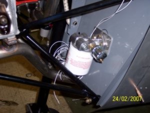

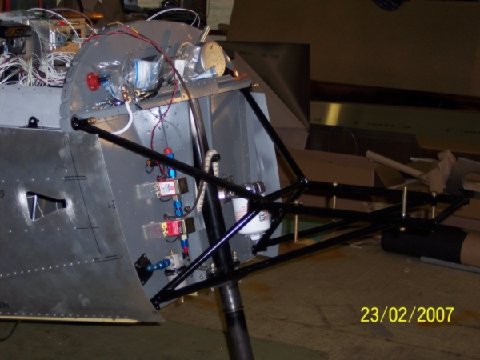

PostPosted: Fri Apr 13, 2007 2:18 pm    Post subject: Corvair Firewall Reply with quote
All-
As you know, sometimes you save time by taking sthe time to research. I don't think this was a stupid question, and I think it's one that anyone considering a Corvair install should think about before punching holes in a hard to replace firewall.
Thanks to all for your input. Unlike the cattycorner brace question, there is a definitive answer to this one, and now it's in the archives for future builders to refer to.
It took me a week to get an answer to my question, probably because I didn't communicate exactly what I was looking for well. Now do all you listers see the need for a place you can go to get definitive answers to questions that have been puzzling builders since Moses was the foreman at Zenith?

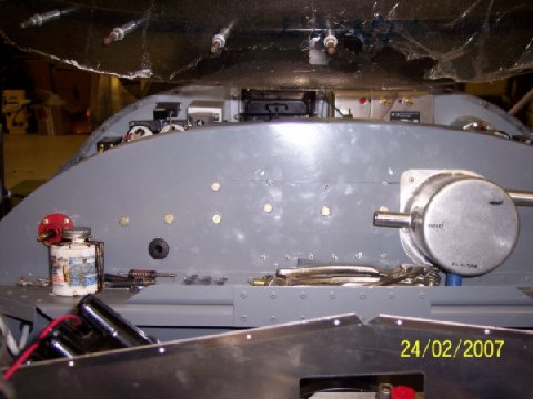

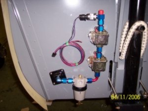

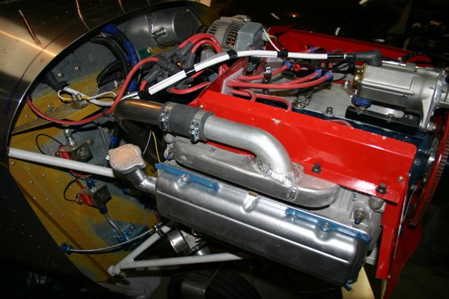

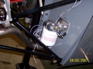

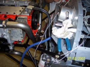

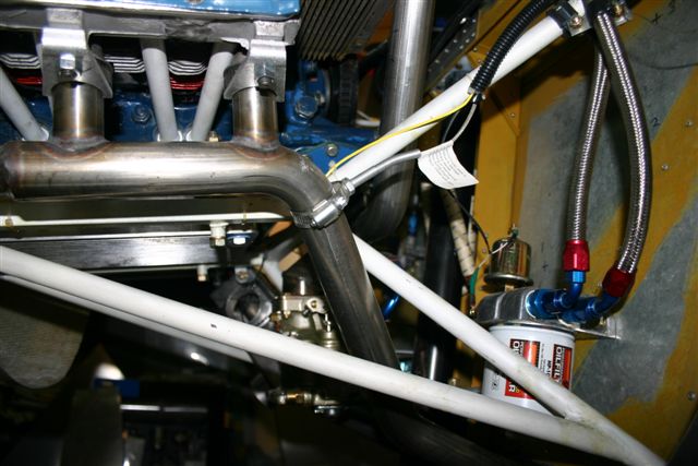

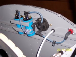

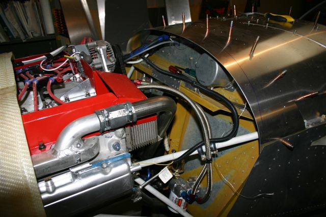

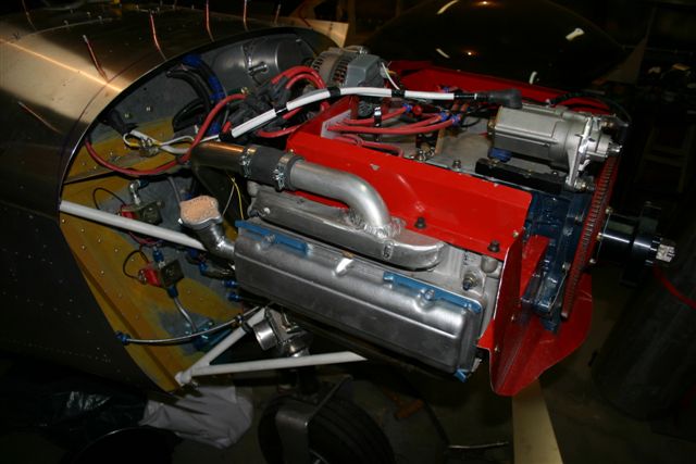

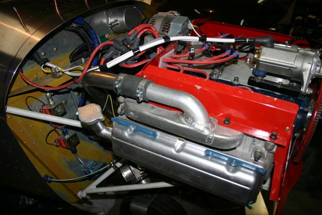

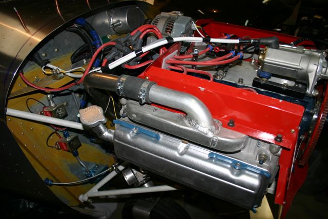

Afterfxllc(at)aol.com

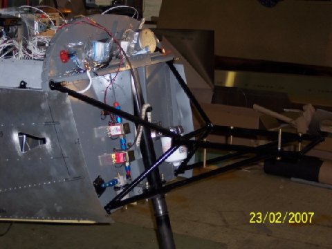

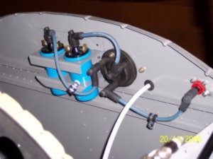

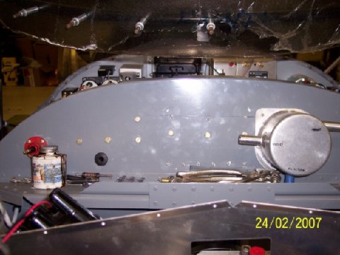

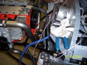

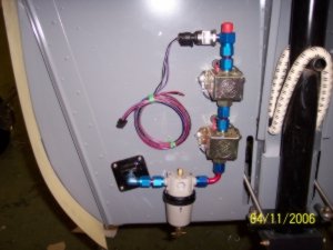

PostPosted: Wed Apr 25, 2007 5:45 pm    Post subject: Corvair Firewall Reply with quote
I have a complete FWF finished and can give you any information and measurements you need. here are some pics.
See what's free at AOL.com.
 Filesize:  15.13 KB
 Viewed:  403 Time(s)
 Filesize:  14.24 KB
 Viewed:  424 Time(s)
 Filesize:  33.3 KB
 Viewed:  431 Time(s)
 Filesize:  15.63 KB
 Viewed:  427 Time(s)
 Filesize:  35.13 KB
 Viewed:  399 Time(s)
 Filesize:  16.5 KB
 Viewed:  383 Time(s)
 Filesize:  20.8 KB
 Viewed:  436 Time(s)
