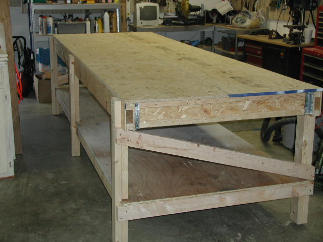

An excellent set of plans for a 4 by 12 table are at http://www.ch601.org/tools.htm
Scroll a bit down the page and look for "table plans". I built this table for my 601XL project.

Take a look at my worktable construction page here
http://home.comcast.net/~kevinbonds/Worktable.htm

Engineered I-beams aren't perfectly straight either. My table is
unbelievably flat. No shimming required.
