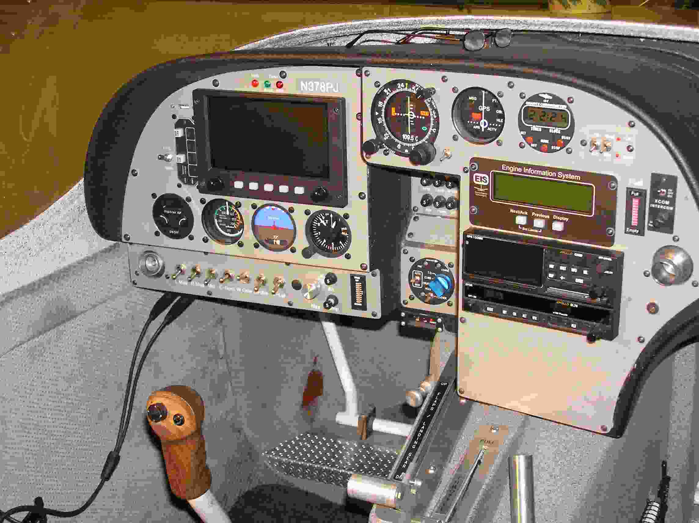

paul.mcallister
Joined: 09 Jan 2006 Posts: 177 Location: Waukesha, WI USA
Posted: Sat Apr 14, 2007 7:48 pm Post subject: EFIS thoughts |
Hi Martin,
I installed the GRT Sport and I am delighted with it. I already had the GRT EIS engine monitor so it made the decision a bit easier. I liked the Dyon but despite the manufacturers claim it isn't very readable in the sun light. The Dyon has a bigger display, and although bigger is better I couldn't have done the panel layout that you see in the photos, which is really what I wanted to do.
The EFIS Sport worked perfectly right out of the box with the minimum on fuss. I intend to exchange the T&B for a 2 1/4 ADI from TruTrack when it becomes available. The ADI is a and AH + digital heading, almost like an AH & a DG in one instrument. Nice box but it is a bit expensive.
Contact me off forum if you would like to know more.
Regards, Paul

UVTReith(at)aol.com Guest
Posted: Mon Apr 16, 2007 1:58 am Post subject: EFIS thoughts |
Hi All, looking for an EFIS like Dynon.
As the smart-Brabus engine has no connection for vauum pump I sold that stuff and bought an Dynon D100.
Yes- it's true, you have to pay in advance without security.
With my big other instruments still in hand, I simply made a new panel layout for the monowheel.
The four 80 mm (3 1/8") instruments ASI - VSI - ALT will go on top (from left to right) and the electr. turn c. will go left beside the D100. Then I have two 57 mm (2 1/4") holes - one for prop setting and one still free - maybe for S-code Transponder.
PLease see attached picture.
Good building and flying to all,
Bruno
