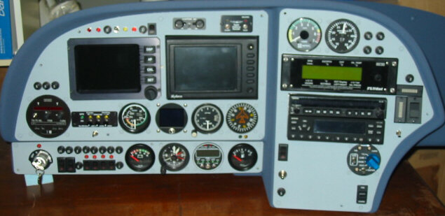

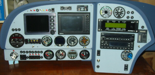

Hi Martin,
Saw your note on the Europa Web and thought you would like a picture of my panel. Note that I also have a complete set of miniature guages - I feel that they are essential. The EFIS is a Blue Mountain Lite plus Gen 4 and it is pretty good although the earlier ones were very troublesome.

Hi Trev.
I'm looking very close to your same setup. But using the large Dynon in place of the Blue Mountain.
What is that back up instrument between the Airspeed and the Altimeter? It's not an electronic miniature horizon is it?
It is not clear to me if full size ASI ALT and AI will fit in the panel under a Dynon D100. It looks too tight.
There are a number of option for 2 1/2" AS and ALT but few Attitude indicators. The only one I have found is from Mid West Instruments. They offer a small trio pack. ASI ALT and AI
The 2" trio backup set from Mid West is unbelievably expensive. I would like to consider options to that same setup

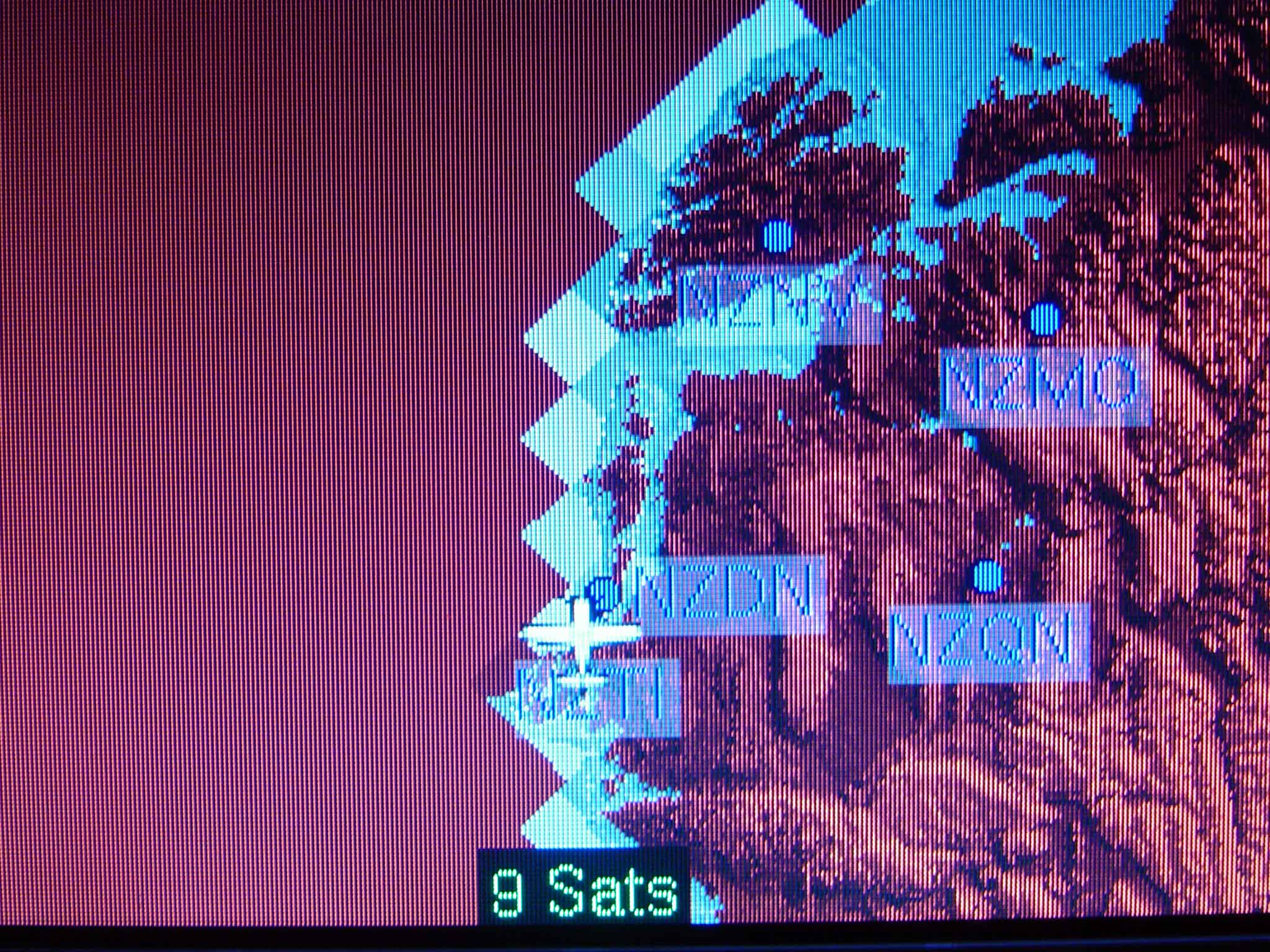

Here is a photo of my BM EFIS GPS terrain display, showing only red and white and breaking up round the coastline.
Keith Hickling,

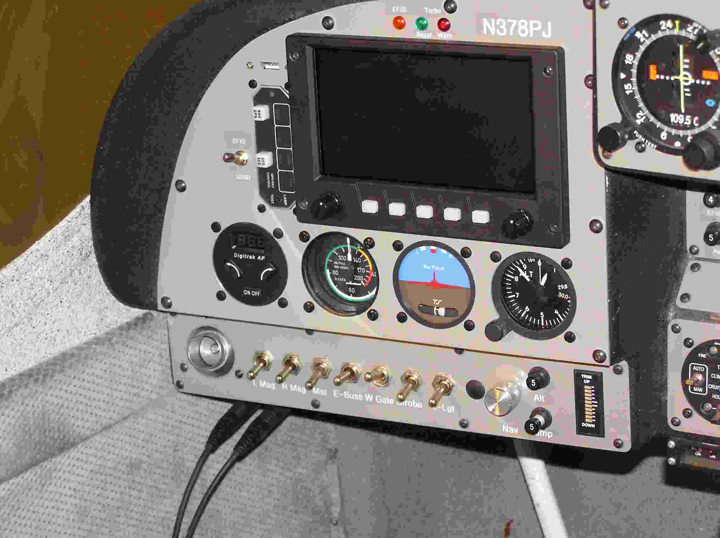

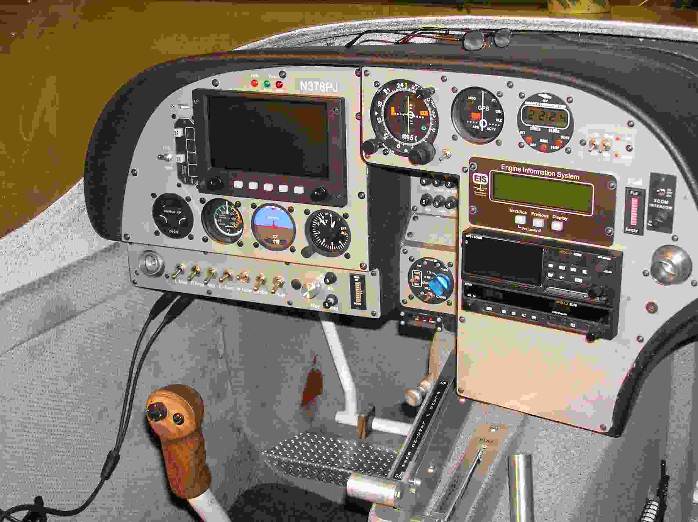

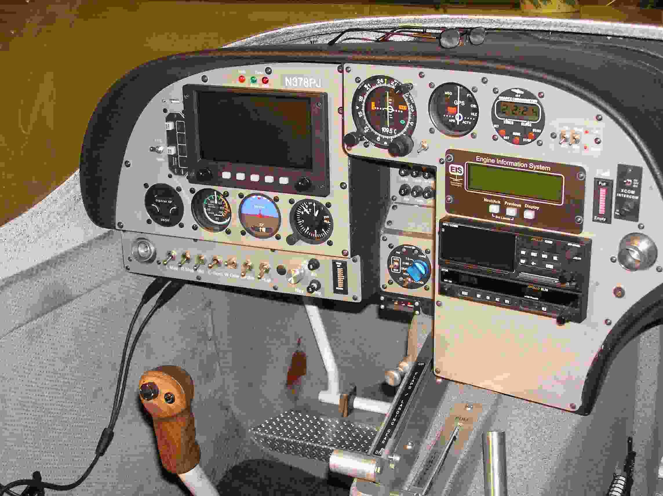

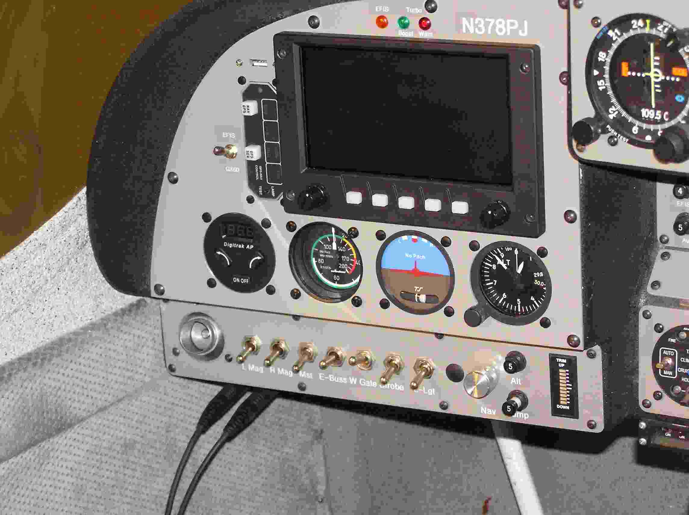

I installed the GRT Sport and I am delighted with it. I already had the GRT EIS engine monitor so it made the decision a bit easier. I liked the Dyon but despite the manufacturers claim it isn't very readable in the sun light. The Dyon has a bigger display, and although bigger is better I couldn't have done the panel layout that you see in the photos, which is really what I wanted to do.
The EFIS Sport worked perfectly right out of the box with the minimum on fuss. I intend to exchange the T&B for a 2 1/4 ADI from TruTrack when it becomes available. The ADI is a and AH + digital heading, almost like an AH & a DG in one instrument. Nice box but it is a bit expensive.
Contact me off forum if you would like to know more.
Regards, Paul

Hello Keith,
Sounds like you're seeing a lack of terrain data (white, or red/white checks). BMA had issues around the US coastline, too, but the recent terrain database (Feb 07) "fixes" the problem and it doesn't look as bad. You might try a software update to see if the "fix" applies to the NZ coastline, too. I wouldn't bet on it... but it's worth a shot.
It shouldn't affect the operation of the unit at all, but it will certainly be annoying seeing all of that checkerboarded terrain! If the software update doesn't change things, send notes to both Greg and Ross directly (greg(at) and ross(at)bluemountainavionics.com (ross(at)bluemountainavionics.com)) to see if they can work the problem. They're busy, but it's uncommon for them not to respond at all.
Good luck!

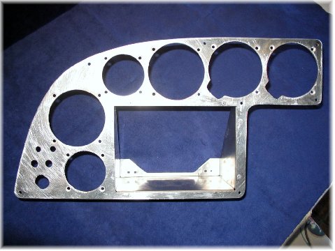

Hi All, looking for an EFIS like Dynon.
As the smart-Brabus engine has no connection for vauum pump I sold that stuff and bought an Dynon D100.
Yes- it's true, you have to pay in advance without security.

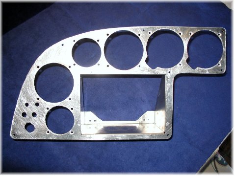

With my big other instruments still in hand, I simply made a new panel layout for the monowheel.
The four 80 mm (3 1/8") instruments ASI - VSI - ALT will go on top (from left to right) and the electr. turn c. will go left beside the D100. Then I have two 57 mm (2 1/4") holes - one for prop setting and one still free - maybe for S-code Transponder.
PLease see attached picture.
Good building and flying to all,
Bruno
