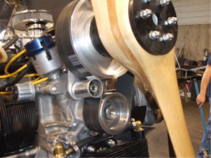

Valley Engineering has been working on and testing a update of the redrive that I have been using on my VW powered Kolb. The update is designed to solve the harmonic vibration issue that I have had. This is the same design of redrive that they are using on their V twin powered "backyard flyer". I'm still asking questions but everything I have heard so far sounds like a major improvement. The harmonic dampening comes from a spring loaded tensioner on the slack side of the ribbed drive belt. If everything checks out I may be the first customer. Hopefully not a test pilot. They as always are very good to me and will be offering a trade in/trade up on my old drive for some unspecified, at this time, amount. The attached is a photo of their new redrive.

Belts are a problem, always breaking, or stripping thier teeth. The are good for driving alternators etc.., but for spinning a prop I would much rather have gears. Rotax did good when they put gears in all thier engines rather than going with some cheap, jury rigged solution.
Redrive units have a terrible record. I hope you dont hurt yourself or tear up your plane when that thing fails.

| Quote: | | Rotax did good when they put gears in all thier engines rather than going with some cheap, jury rigged solution. |
Rotax did do well with their gear box design. This, however, does not mean that a belt drive is a "cheap jury rigged solution." Besides, if it is jury rigged, is it really a solution?
Last year we replaced the gears in one of our chopping machines at work(45HP main drive) with a belt drive system of our own design. We have not had a failure yet. Before the upgrade we were losing $3000 worth of gears every 2-3 weeks. One must simply match the design to the application. A well designed belt drive will outperform a poorly designed gear drive and vice versa.

Mike/All
I agree that a gear reduction drive would seem to be a better solution if it
designed for its application. There are a few universal redrives available
that might work for a VW but without the proper engineering there is a much
better chance of it failing or causing something else to fail than with my
old belt redrive. As for a universal statement that belts are cheap, jury
rigged, and have a terrible record, this isn't the case. This drive
manufacture has hundreds of drives on the market with a good record. This
redrive has had only one failure that I know of (in my plane and no it
didn't hurt me or the plane). The part that failed wasn't the belt, it was
beefed up and is working well. All old drives and drives since now use the
stronger part. This new drive is a evolutionary improvement. As with all
their drives they install, they have more than one belt (my old drive has
three) and test run with one belt to make sure it will carry the load by
itself. Belts do wear and need to be replaced. My current drive belts have
all most a hundred hours on them with no wear. If the new drive belts wear
slightly more but give me a silky smooth operation its a good trade.

Sorry but I think that is rubbish, I have hundreds of hrs on belt drive
engines with no probs.
Also Harley and Buel motorcycles are belt driven and you don't see them
snapping all the time and they are transmitting more power and more
aggressively than a VW conversion turning a prop.

| Quote: | | Belts are a problem, always breaking, or stripping thier teeth. The are good for driving alternators etc.., but for spinning a prop I would much rather have gears. |
Was comparing two ribbed drive belts the other day (about 3" wide x 24" circumference). Could hardly tell the difference between them.
One was brand new, the other had 1,000 hrs on it !
