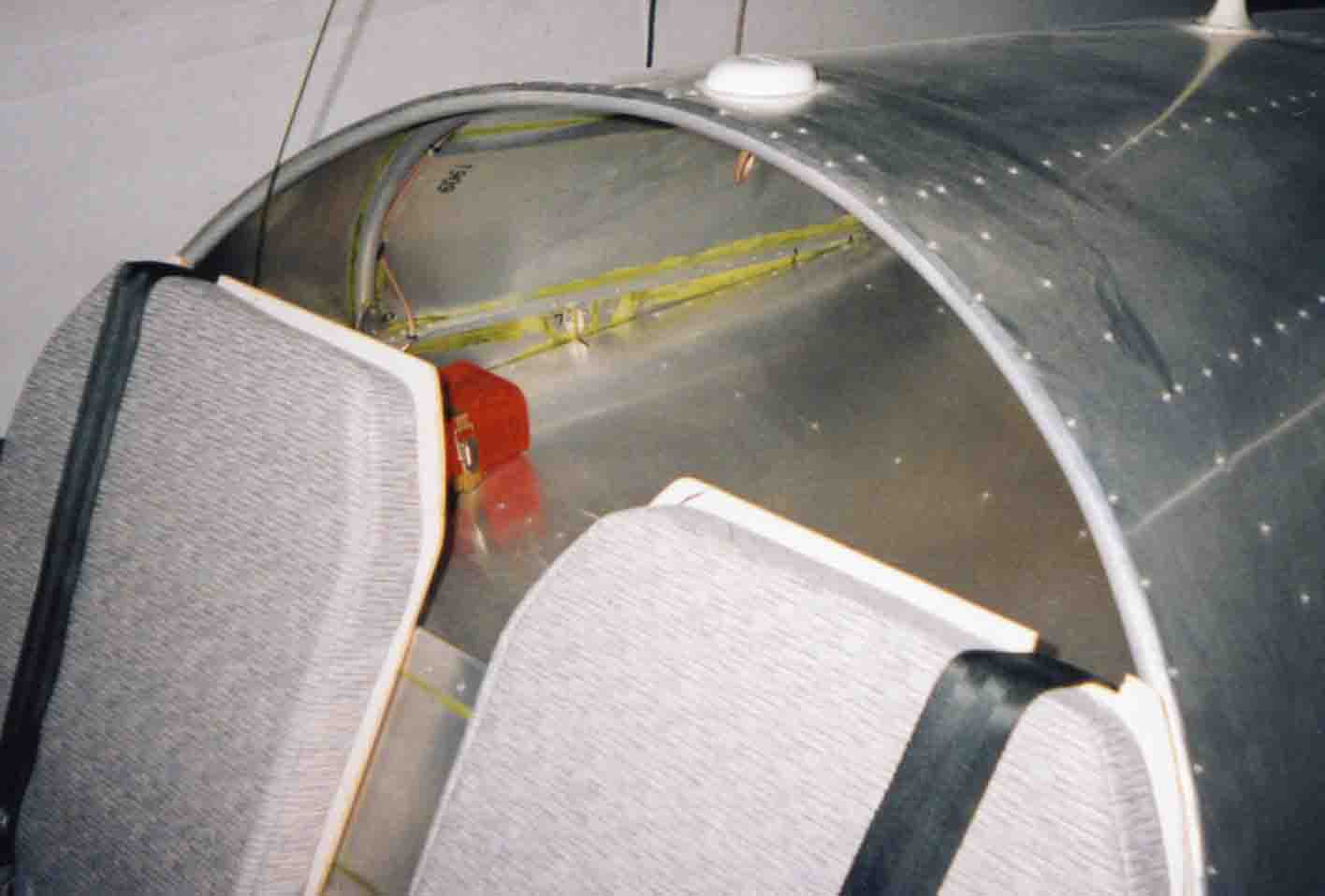

PostPosted: Fri Nov 02, 2007 2:03 pm    Post subject: Locations for headset jacks? Reply with quote
Andy,
I installed my phone jacks where shown on the attached photo. I have not flown with this setup as yet, so I can't comment on "how it worked out." i have caught some flack from some who think that elbows will damage the plugs when they are in place. If that actually happens, I guess I will install some sort of guard around them.
Jay in Dallas 601XL N2630N
"Dr. Andrew Elliott" <a.s.elliott(at)cox.net> wrote:
I am getting to the point of wiring, and was interested in hearing if anyone has tried any "unconventional" locations for the headset jacks.
I would call anywhere in the panel, or directly under it, conventional locations. Unconventional ideas might be behind the seats, more or less under or above the shoulder harness locations, or perhaps in the aft inclined part of the center console, or ??
So, who's tried what? And how has it worked out?
Andy Elliott, Mesa, AZ
N601GE (reserved)
601XL/TD/QB, Corvair, building...
 Filesize:  184.38 KB
 Viewed:  815 Time(s)

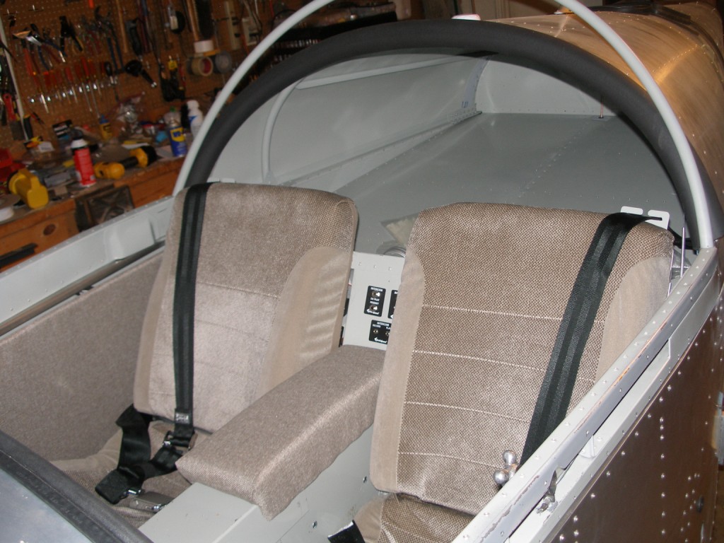

larry(at)macsmachine.com
PostPosted: Fri Nov 02, 2007 4:54 pm    Post subject: Locations for headset jacks? Reply with quote
Andy,
I made a jack-box and placed it behind the passenger seat with it angled
toward me. I also put a speaker on the opposite side with a switch to
listen to ATIS while doing preflight. The headsets and wires stay back
out of the way and it's a comfortable way for me to access headsets for
both passenger and myself.
Very happy with the results.
http://www.macsmachine.com/images/electrical/full/jackbox2.gif
http://www.macsmachine.com/images/electrical/full/speaker-cover.gif
http://www.macsmachine.com/images/seats/full/seatsin2.gif

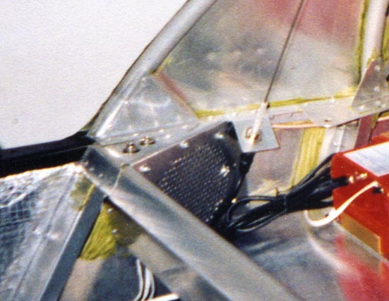

I put mine right at the front outside corners of the baggage shelf in the gusset. They work very well there, the cords are completely out of the way, but I can't easily reach them in flight and I had to cut an opening in my plywood seat back supports to allow room for the plugs to stick up there. If I were doing it again, I would put them a bit further back and maybe at an angle away from the seat back and I would make the seat backs a little narrower there to allow room to reach the cords.
Here's a photo, that's a speaker below the gusset.
 Filesize:  71.54 KB
 Viewed:  754 Time(s)
 Filesize:  55.37 KB
 Viewed:  747 Time(s)
