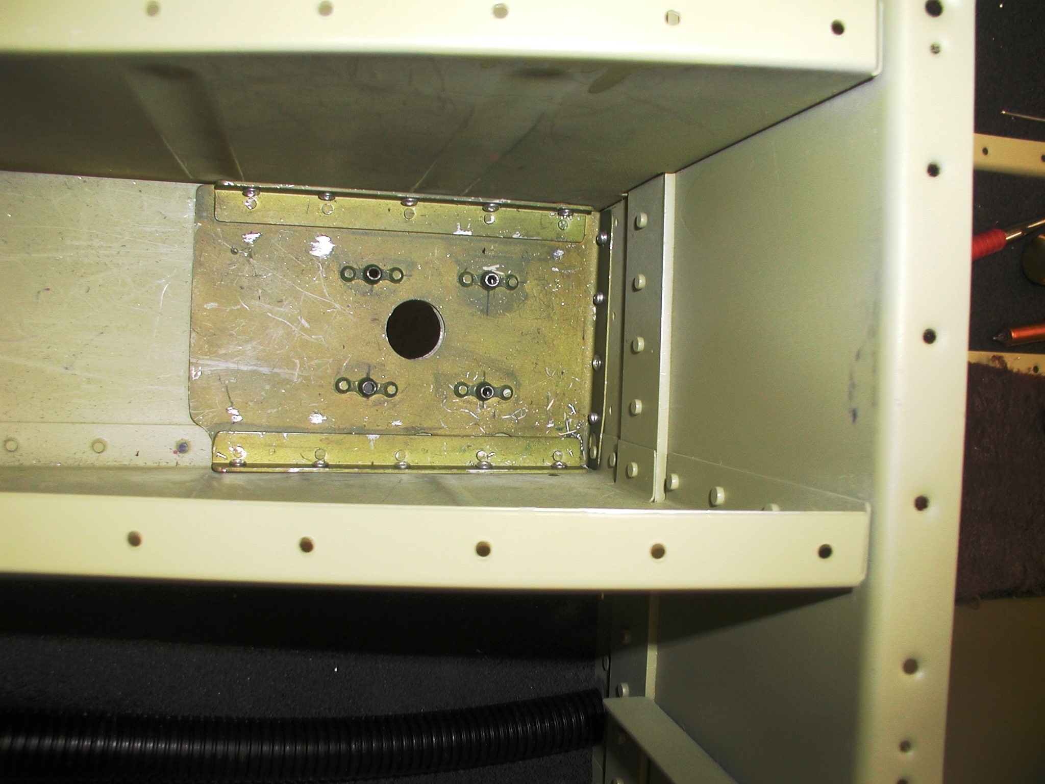

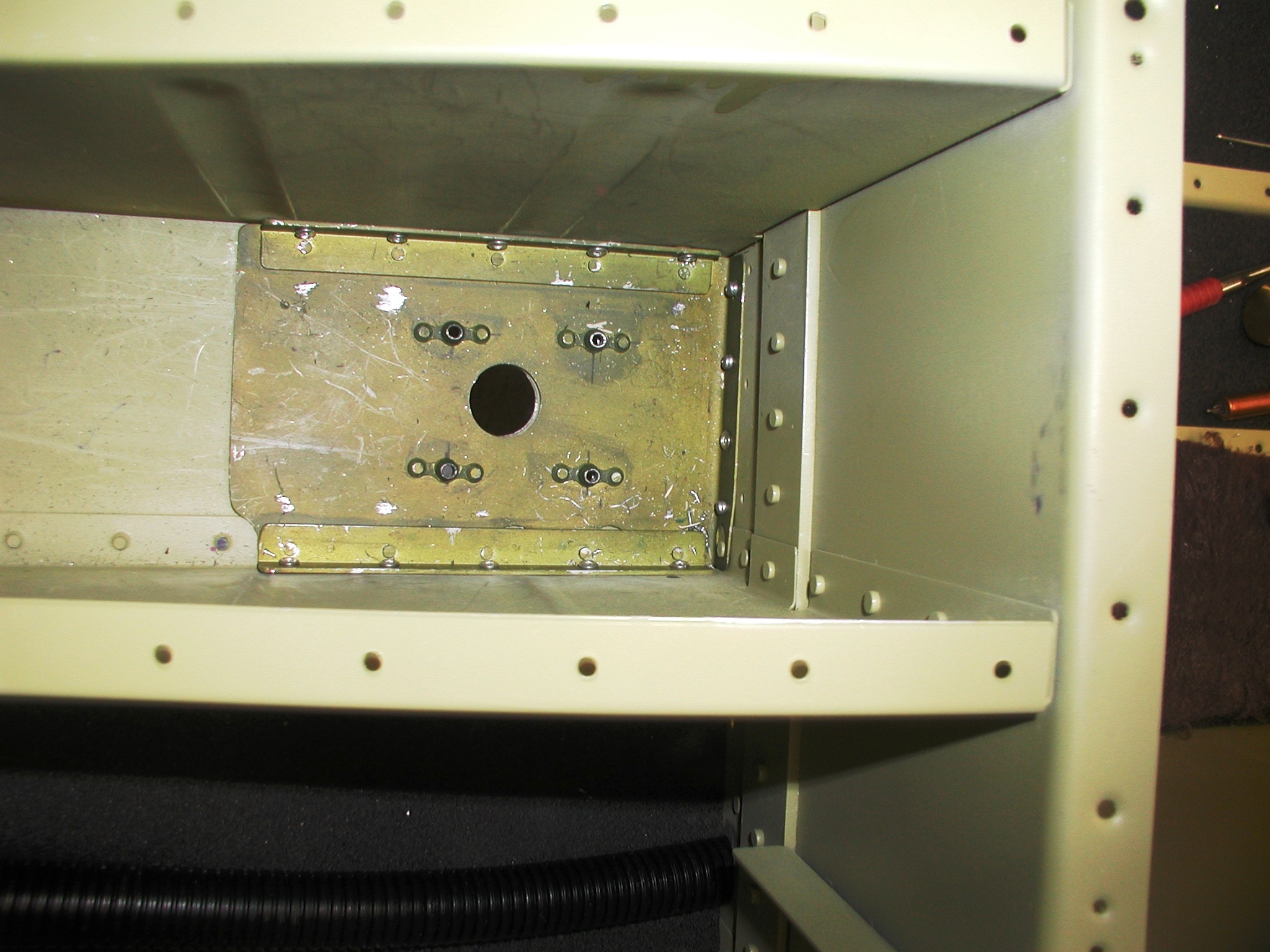

PostPosted: Thu Mar 29, 2007 3:58 pm    Post subject: Comant installation question Reply with quote
Here is my Comant mount under the rear seat. I put the wire in and dropped
it out the bottom and then sealed up the floors. The antenna mounts from the
outside with platenuts.
John Testement
jwt(at)roadmapscoaching.com
