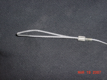

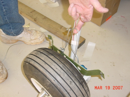

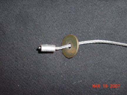

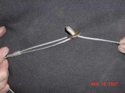

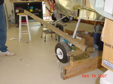

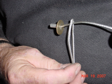

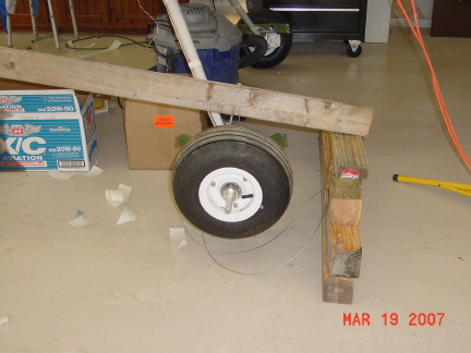

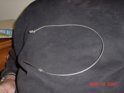

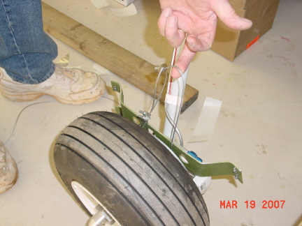

Here are some pictures of a simple jack. It can be carried on the plane and weighs only a few ounces. It consists of a 24” cable that is dropped between the break disc and the wheel pant mounting plate. For your home base you can get fancier for the blocks and lever, but this loop allows you to have it with the plane at all times.

What a great idea! Looks like it might be a little unsteady side to side. Is that an issue at all?

Stability is not an issue. Actually without the wing on I can lift the plane with just a 3 foot board. By the way I used a 3/32 cable and had to flatten the nicropress slightly to get it to slide through after I put on the clear shrink tube.

That's right. The other wheel is on the ground, so side-to-side movement, if any, is a none factor.
