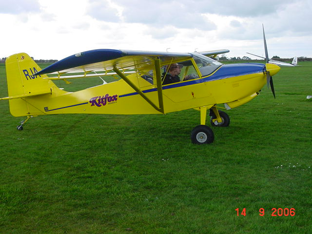

PostPosted: Sat Mar 03, 2007 10:52 pm    Post subject: Re: Radiator Mods for NSI engine Reply with quote
Here is a shot of my series 5 radiator set up. I had the origianl NSI brass unit but had to replace with aluminium one. I have a front exposed scoop inlet and defuser track. Hot day I get 100C on climb& 90 on cruise
