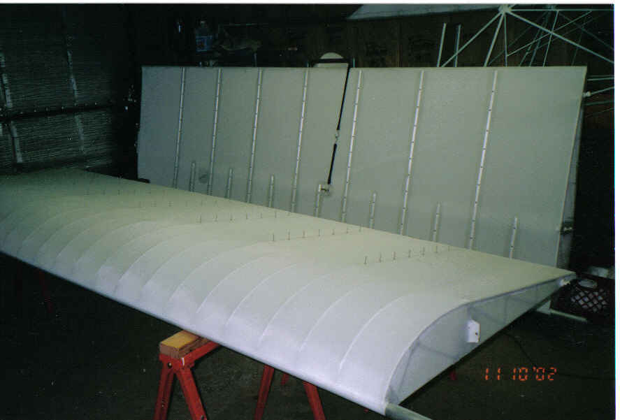

PostPosted: Fri Jan 26, 2007 5:25 am    Post subject: Re: wings Reply with quote
Hi Richard,
Just wondering.....on a Tractor , the rib stitching needs to
be "more" in the area of the prop blast.....
Did you just keep the same pattern all the way , since it's a pusher ?
Gotta Fly...
Mike in MN
 Filesize:  34.99 KB
 Viewed:  342 Time(s)

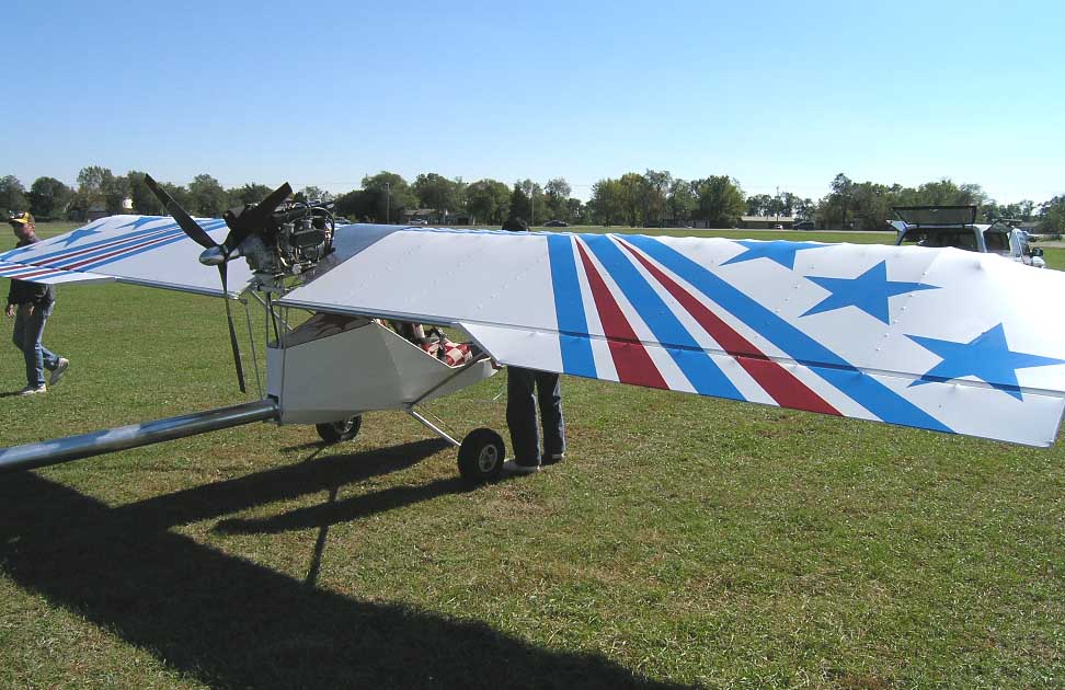

PostPosted: Fri Jan 26, 2007 8:49 am    Post subject: wings Reply with quote
| My only question is: Are the rivets very noticable when the wing
is
| finished???
| Mike in Utah
Mike:
Take a look.
 Filesize:  67.61 KB
 Viewed:  348 Time(s)

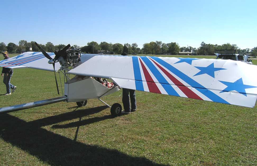

PostPosted: Sat Jan 27, 2007 6:23 am    Post subject: Re: wings Reply with quote
Hey Steve,
I had my Doubts about that drilling jig at first...
But that little sucker really worked GOOD !
Gotta Fly...
Mike & "Jaz" in MN
Picture below is for the question , Are rivets MORE noticeable...
Most picture, the rivets won't show up ( I looked ) but this picture you
can see them.... Judge for yerself
 Filesize:  123.47 KB
 Viewed:  363 Time(s)
