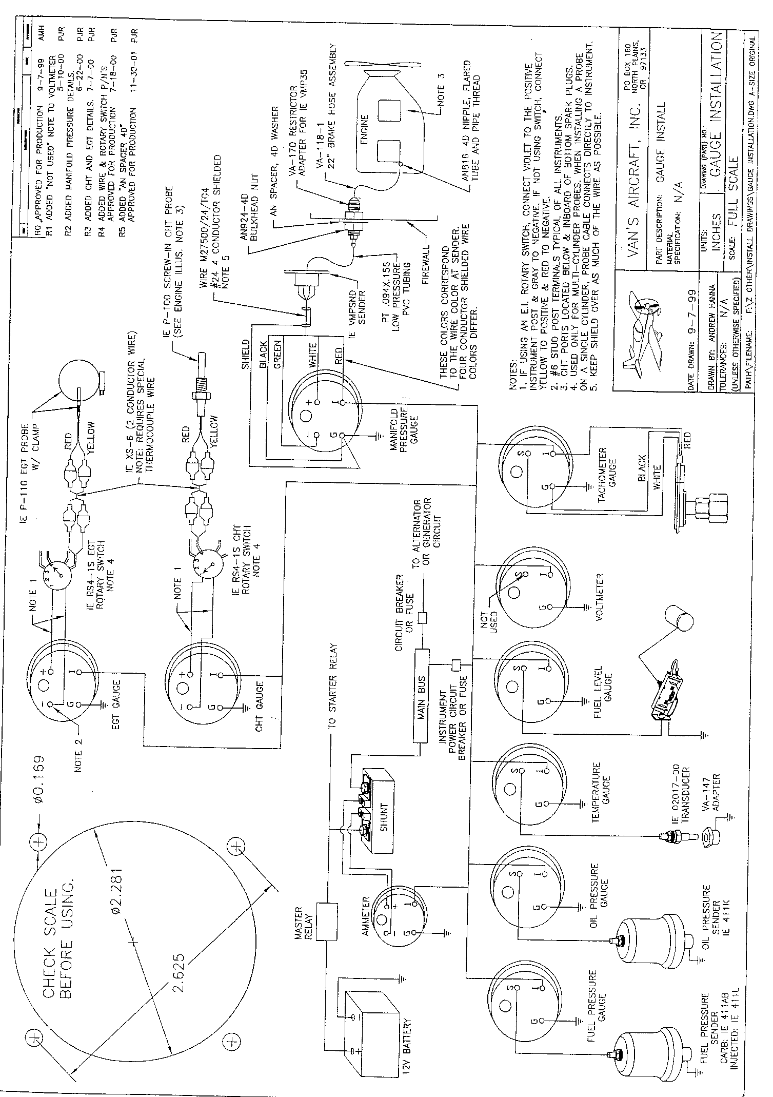

I find myself in need of the wiring schematic for the Isspro fuel
gauges that Van's sells - I think they're #8690, and am unable to find
it at the company website or with Google. I need to know how the
senders wire to the gauges and where the 12V and GND connections are
made.
Confession time: I have these gauges in my plane now, but have lost
the old wiring diagram I drew at the time (which would have been an
embarassment if it still existed, like the rat's nest behind my
present panel). I need the info to design relevant parts of the
diagram for the new electrical system.
-Bill B.

Herewith the required schematic.
Kenneth Melvin, RV-9A N669TJ

On 1/18/07, William Slaughter <willslau(at)alumni.rice.edu> wrote:
At the Van's web site, click on Construction FAQs and scroll down to Gauge
Installation and Diagrams, or direct at
http://www.vansaircraft.com/pdf/Gauge_Install.pdf
William Slaughter
RV8QB almost ready to run some wires
