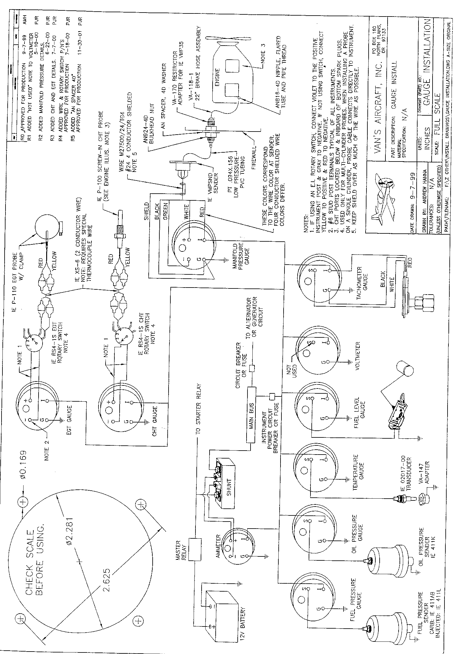

I find myself in need of the wiring schematic for the Isspro fuel
gauges that Van's sells - I think they're #8690, and am unable to find
it at the company website or with Google. I need to know how the
senders wire to the gauges and where the 12V and GND connections are
made.

PostPosted: Wed Jan 17, 2007 7:42 pm    Post subject: how to wire basic resistive Isspro fuel gauges Reply with quote
Herewith the required schematic.

PostPosted: Wed Jan 17, 2007 9:10 pm    Post subject: how to wire basic resistive Isspro fuel gauges Reply with quote
The ISSPRO gages were designed by Van's and manufactured by ISSPRO. ACS&S carrries them without the a Logo and Chief carries them with the Chief Logo.
I ran into the lack of paperwork problem on the ACS&S ordered gages and contacted ISS and got that info. Since then the ACS&S gages I have ordered have a copy of the PDF from Van's tucked in the box.
I also downloaded and printed the page from the Van's site for my files.
Oh, the gages don't like to work properly below 11 VDC, bear that in mind when figuring your depleat battery time during charge failure. (or when running tests in the shop..hehe..ask me how I know)

On 1/18/07, William Slaughter <willslau(at)alumni.rice.edu> wrote:
At the Van's web site, click on Construction FAQs and scroll down to Gauge
Installation and Diagrams, or direct at
http://www.vansaircraft.com/pdf/Gauge_Install.pdf
