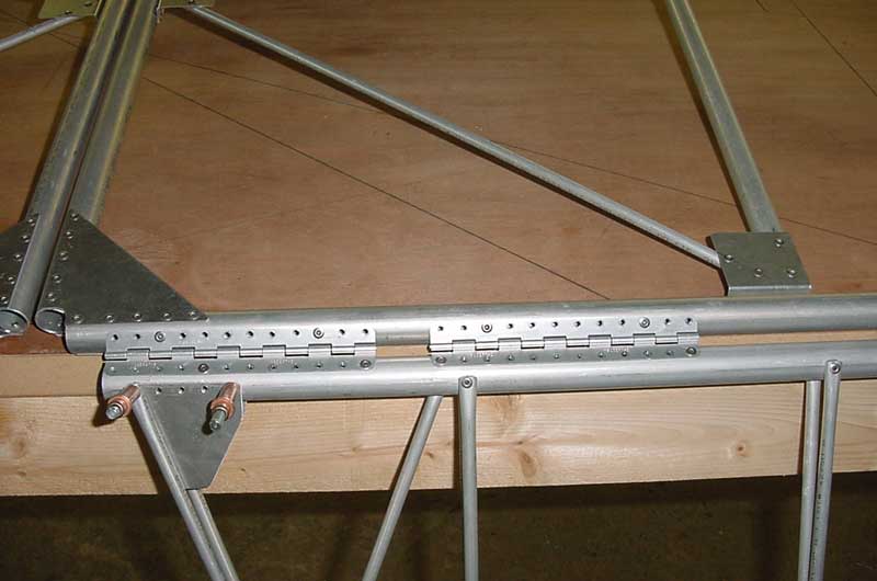

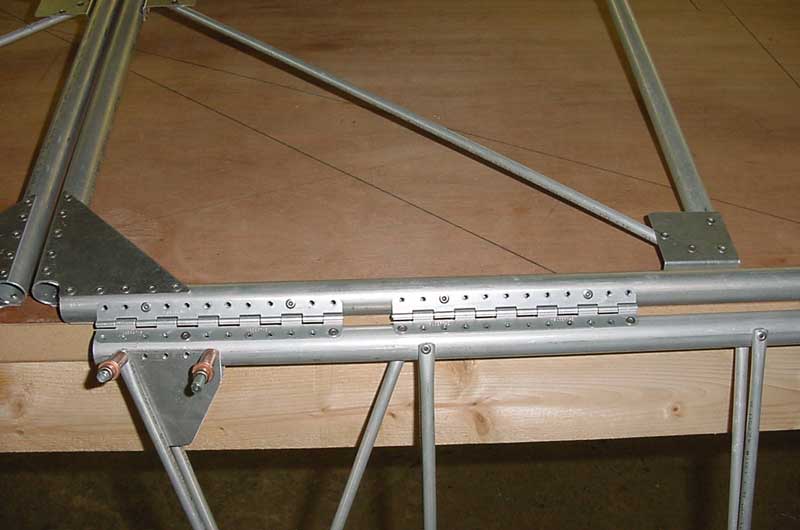

Maybe Kolb should go in the go-cart business too?
Did you notice the extra corner gussets on the elevators and rudder? I figured i would build mine in instead of adding them later like you had to do. Smile

Hi Scott:
Glad you picked up on the corner gussets. Don't forget the rudder
too.
Has Kolb incorporated them into the plans? I think not, but have not
seen the new mkIIIx plans.

PostPosted: Mon Jan 15, 2007 3:58 am    Post subject: Re: Mark II Xtra update Reply with quote
John Hauck wrote:
Hi Scott:
too.

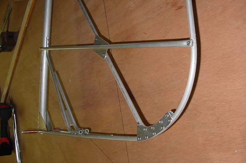

We put gussets on the rudder as well. I just didn't post a seperate picture of them.
And no. There are no corner gussets on the plans. I noticed them on your plane (at) Sun-n-Fun last year but never got around to asking you about them. Looking at the design it made sense that the single rivet would see a lot of rotational stress so we just went ahead and added them. In the attached pic you can see the corner gussets as well as the slight changes to the cross bracing to help transmit rotational forces to the rudder TE
| Scott
Morning Scott:
Rudder looks good, clean and strong.
