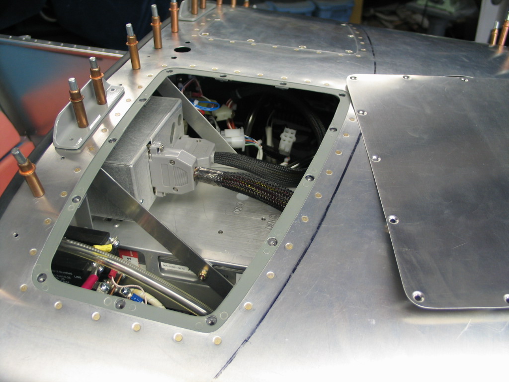

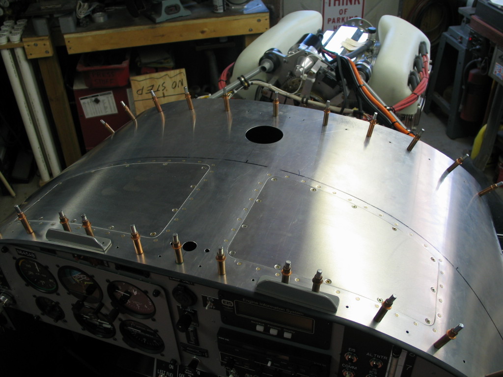

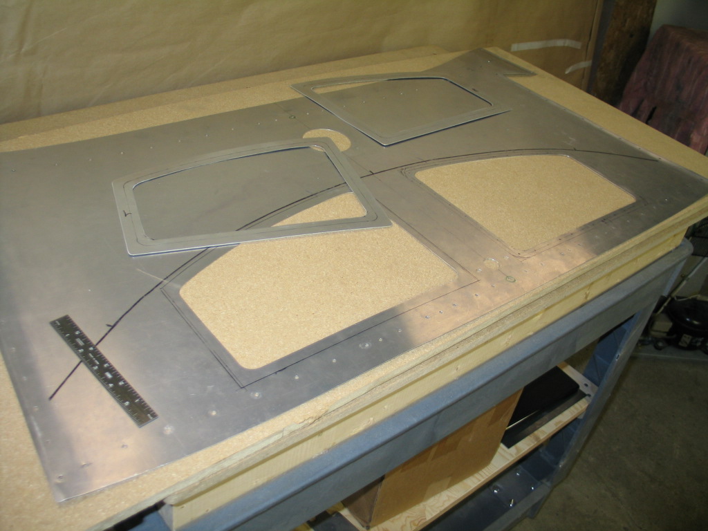

agbeyer(at)sbcglobal.net
PostPosted: Mon Dec 04, 2006 6:51 pm    Post subject: Forward Skin Access Reply with quote
Hi Guys,
Here are some pics of my inspection covers. I used floating nut plates.
Al from Oshkosh
601 HDS
 Filesize:  182.01 KB
 Viewed:  386 Time(s)
 Filesize:  196.57 KB
 Viewed:  417 Time(s)
 Filesize:  194.35 KB
 Viewed:  450 Time(s)

amyvega2005(at)earthlink.
PostPosted: Mon Dec 04, 2006 7:27 pm    Post subject: Forward Skin Access Reply with quote
that is the cleanest job I have seen. Obviously you have built before. HOw did you get such smooth cuts on the frame in the first picture?
I believe that is the frame for the cover?
Juan
