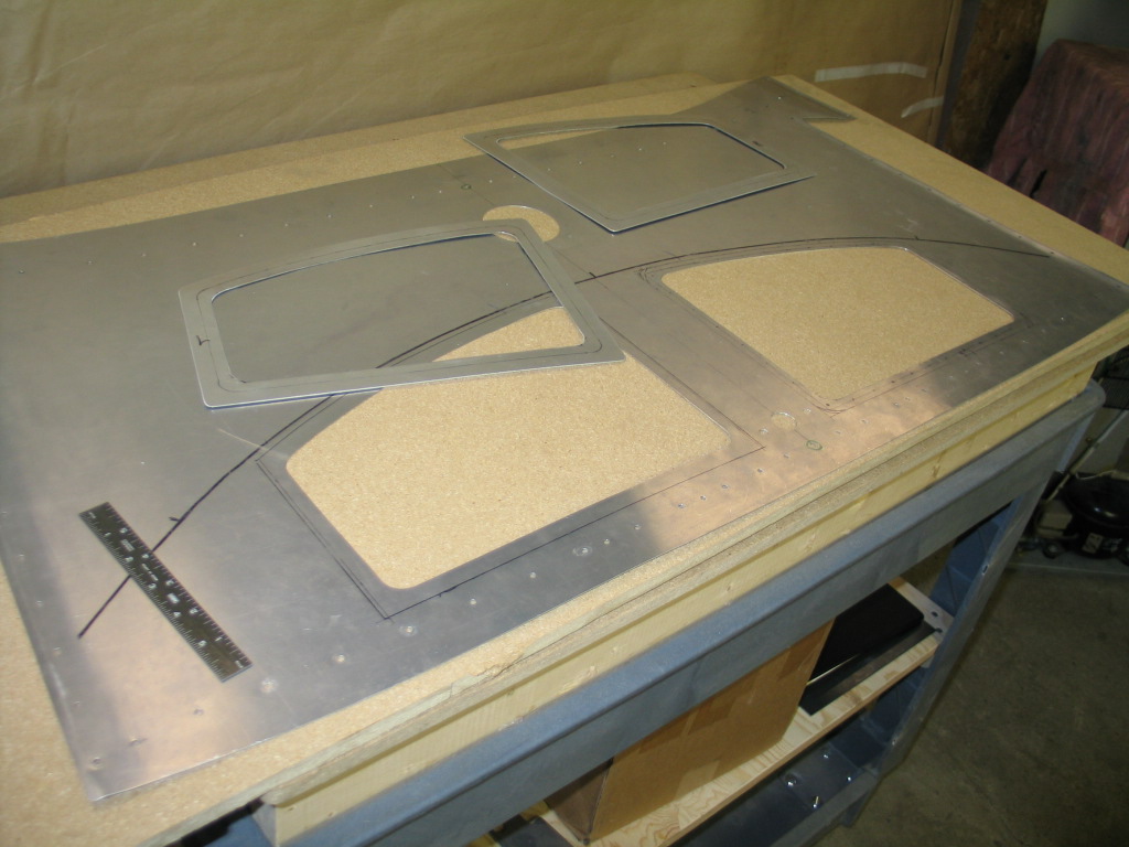

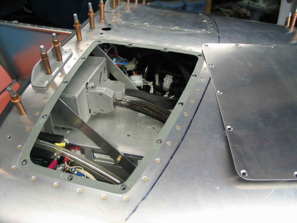

agbeyer(at)sbcglobal.net Guest
Posted: Mon Dec 04, 2006 6:51 pm Post subject: Forward Skin Access |
Hi Guys,
Here are some pics of my inspection covers. I used floating nut plates.
Al from Oshkosh
601 HDS

amyvega2005(at)earthlink. Guest
Posted: Mon Dec 04, 2006 7:26 pm Post subject: Forward Skin Access |
great website by the way, you need to send me the plans for that kick ass recumbant Bike!
Do you have close up pics of the portion of the turtle deck you riveted, the very end pieces adjacent to the canopy screw. I like your idea.
Juan
| | - The Matronics Zenith-List Email Forum - | | | Use the List Feature Navigator to browse the many List utilities available such as the Email Subscriptions page, Archive Search & Download, 7-Day Browse, Chat, FAQ, Photoshare, and much more:
Posted: Mon Dec 04, 2006 7:27 pm Post subject: Forward Skin Access |
that is the cleanest job I have seen. Obviously you have built before. HOw did you get such smooth cuts on the frame in the first picture?
I believe that is the frame for the cover?
Juan
