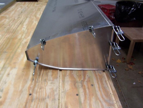

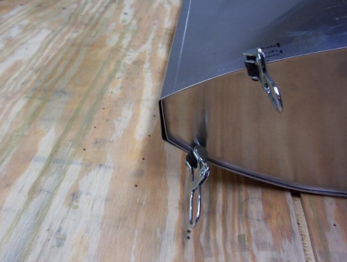

Scratch Builders,
I am making the end caps for the fuel tanks and wanted to ask others about forming the corners. Should I shrink the metal and have a corner all around? Or, just form the flanges and leave the corners out and fill with weld?
I made some parts with 5mm constant flange, but had to anneal the corners to get the 6061 T6 material to flow. The parts look OK just didn't know about fatigue in the corners.
What do you think?
Pictures attached at the forum

Ron,
A nice shape to work with, but I'd reverse the ends placing the flanges
under the main skins as you've done so that the heat
you put into welding is better distributed between the cap flange and
the edge of the main skins. 6061-T6 is not the best material
for a tank as applies to a welded construct. 5052-H32 is ideal as it's
yield to work hardening is better for holding its shape.
You're corners will fill easily the way you've got them, but if
reversed, a little easier. You can put more material into the weld if
you've got 1/8-inch of drum hanging outside the main skin edge and the
edge won't burn away so readily as the edge weld of a typical flange-
weld would. Practice a lot before you ruin the first set of tanks by
making sample welds to proof your skills or that of the guy you entrust
to the job. I welded the tanks with clecos and then removed the clecos
one by one and welded them shut. If you want to make the job of welding
much easier, make the ends out of .040 if you haven't already as less
than that is difficult to control heat- distortion and get consistent welds.
Best of luck,
Larry McFarland - 601HDS at www.macsmachine.com

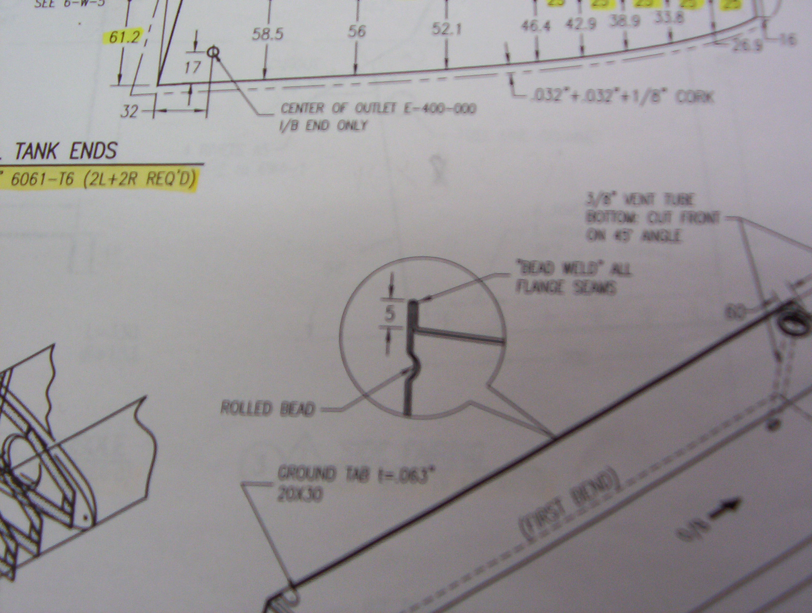

Larry and Wayne,
The print shows the edges coming together like the picture below and has a notation "BEAD WELD ALL FLANGE SEAMS". This should make it easier to fuse the materials while adding filler rod and it should also make a really strong joint. I'm not to sure about the methods you are speaking of so I will probally make it like the print. I am still open for suggestions.
