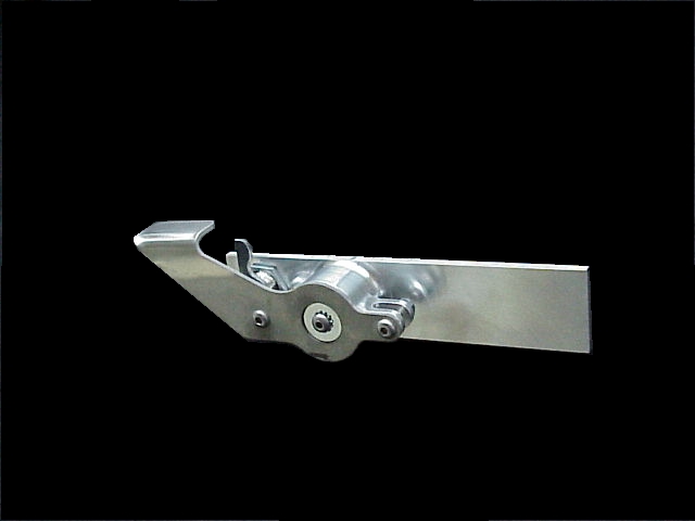

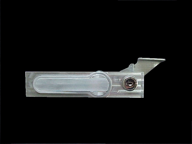

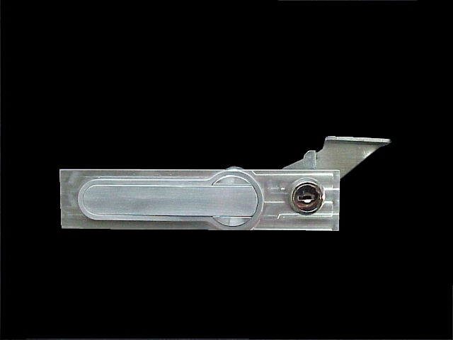

I’ve been working on kitting up an install using these billet flush handles. I need a week or two more to finish up but I’ll post some pics of the handle now and follow up later with some install pics…
Steve
