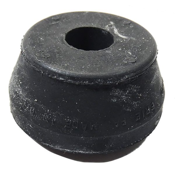

[img]cid:9CB3AEF7-9591-4D90-929C-26C792175AF5[/img]Lord Engine Mount # J-3608-1
aircraftspruce.com
Softer tho, so you need to adjust with a shorter spacer
Cheers,
PeteZ

Re the motor mounts:
Engine Rubber Isolation Mounts:
1.            Europa Rotax Mount MT04 hard mount.
Alternate isolation mount:
1.            A/C Spruce Part# 08-00662 but not sure of how firm the rubber is.
MFR Model # SET OF 8  About $50 plus shipping/tax
2.            Lockwood 860-690 is really expensive $30 each.  Just a Lord Mount J3608-1
Bud Yerly

I love my lords….waaaay quieter than the old europa rubbers,

PostPosted: Tue Feb 14, 2023 11:40 am    Post subject: MT04 Engine mounts Reply with quote
Pete
How much did you shorten the spacers?
Will
William Daniell

PostPosted: Wed Feb 15, 2023 3:43 am    Post subject: MT04 Engine mounts Reply with quote
Hi William,
Had to reduce the spacer lengths to 1.500” to deal with the very large startup and shutdown movements of the high compression 912ULS.  That said I believe Erich with his lower compression 914 got away with 1.592” which I found to be *really* quiet and smooth - except with my 912ULS it would bang around during startup and shutdown (when I had the heavy and gear-box abusing warpdrive, I may be able to lengthen them with my now super-light E-prop).
Cheers,
PeteZ
