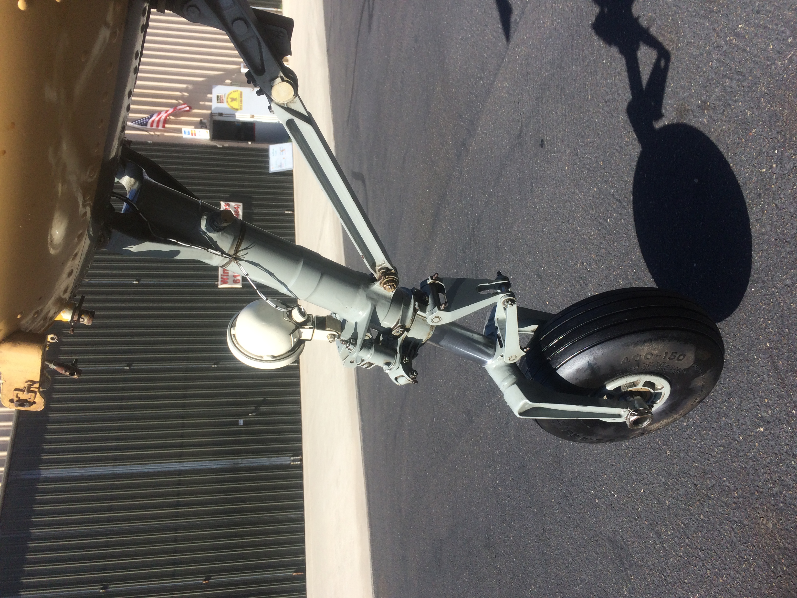

You’ll see a GE lamp bolted to the nose strut on many 52’s Rico.
. Which should illuminate the runway nicely.
Mind you, the minute you pull power after the runway’s made in a night landing, all YOU are going to see is the blinding glow from the Red Generation fail light.

Ha ha! But what is used for a housing or bracket? There’s a dozen great LED lamps. But mounting is the holdup for me, John…

[img]cid:185f6ff429227a7c7f41[/img]

Awesome! Where can I find one?

Wait for people to chime in here, I suppose.
This 52 with the forward facing lamp bracket mounted off the shimmy dampener was from the mid-nineties boom era - so I imagine at the time these were readily available from all the usual sources.
…Just like ‘old man’ wing steps, and many other accessories that now seem much harder to find new.

That light was stock on most all early Cessna 310.  Contact most any aircraft salvage outfit.
.. Which should illuminate the runway nicely.
It’s a character builder for sure.

PostPosted: Sat Jan 28, 2023 9:31 am    Post subject: Yak 52 Landing Light Reply with quote
There he is.
Hello Doug. Go to see you here.
Mark
N621CJ.
On Sat, Jan 28, 2023 at 12:29 PM doug sapp <dougsappllc(at)gmail.com> wrote:
[quote] That light was stock on most all early Cessna 310. Contact most any

See! “the truth is out there”
Thanks Doug👍🏻👍🏻👍🏻
