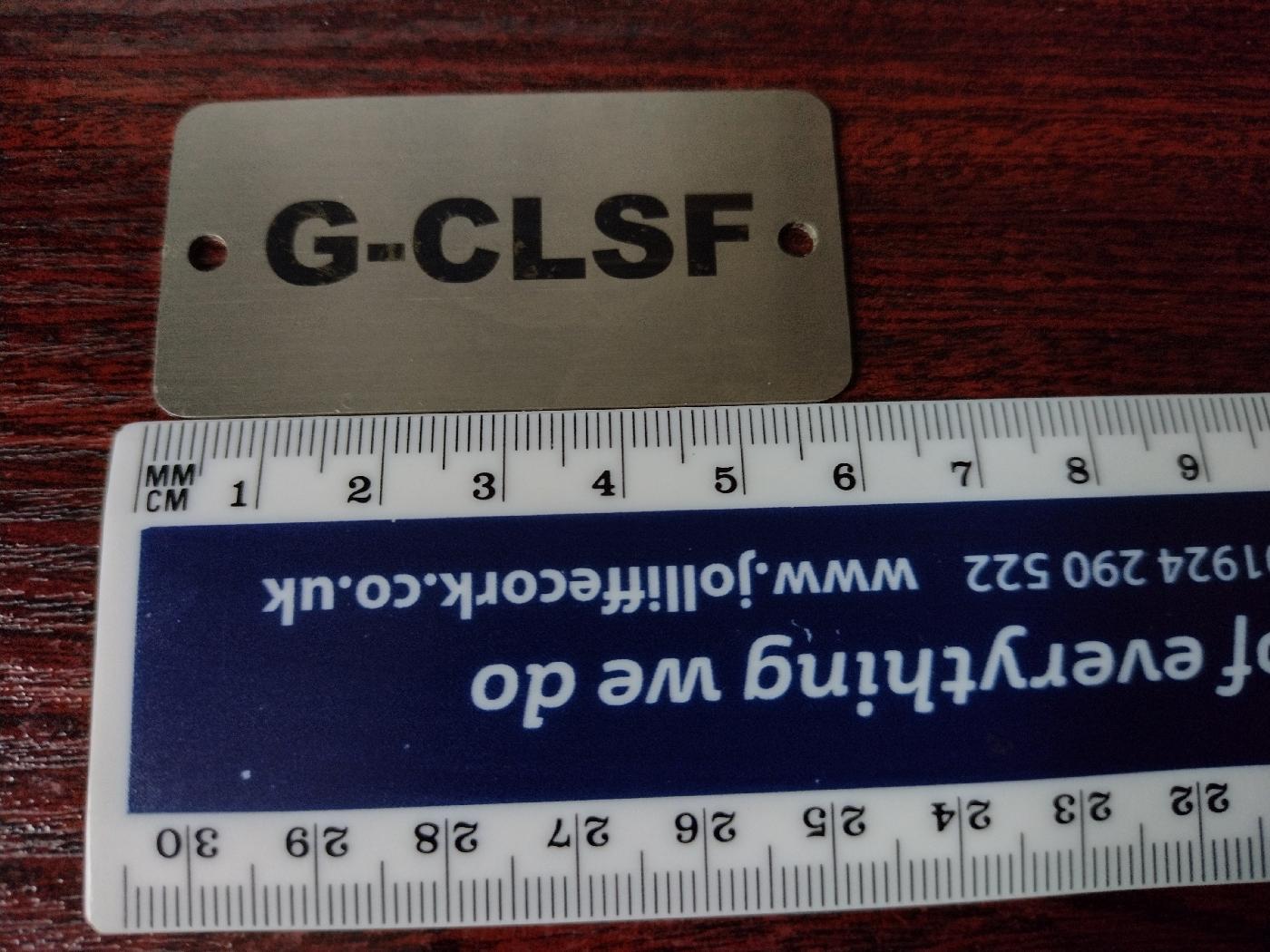

BobD
Joined: 05 Jan 2016
Posts: 117
Location: Sheffield UK
PostPosted: Sat Oct 29, 2022 2:11 am    Post subject: Re: size of aircraft data plate Reply with quote
Rowland,
The attached example (from another aircraft I built and sold recently) is 60mm x 30mm. I located it on the Control Panel in a prominent position (which helped me remember the correct call sign when making radio calls !). It is made from steel, and cost less than £12.00. It came from
https://www.signomatic.co.uk/
I believe it satisfies the requirements of CAP 523
The reason I still have this is that I was unsatisfied with the colouring of the letters. They replaced it without any problem.

Rowland_Carson
Joined: 04 Jul 2008
Posts: 155
Location: Cheltenham, England
PostPosted: Sat Oct 29, 2022 2:22 am    Post subject: size of aircraft data plate Reply with quote
Thanks!
