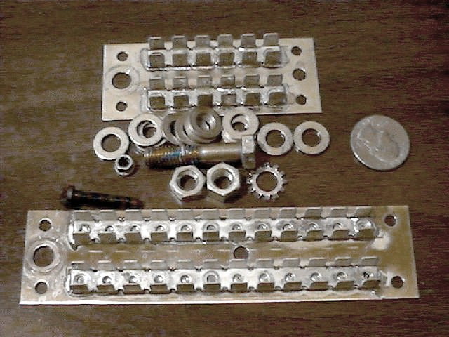

The original design I crafted for B&C's products
SOLDERED strips of tabs to the base plate. This
preserves electrical integrity between bus plate
and tabs.
At the time it was designed the target mounting
surfaces were stainless and composite
firewalls.
This assembly can be mounted on an aluminum surface
that stays dry.
Riveted assemblies are not recommended.

 Filesize:  201.78 KB
 Viewed:  4700 Time(s)

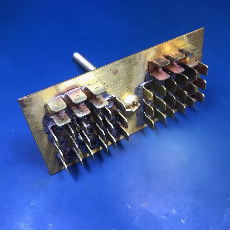

I built mine by setting a brass plate on top of a burner on my gas cooktop. Then I smeared solder paste on the bottom of several 6-way quick-connect tabs and placed them where I wanted them on the plate. Finally, I turned the burner on low and waited for the solder paste to reflow. Photo attached.
If you do it this way, turn the hood fan on high (there's some smoke) and have some sort of heatproof tool handy to nudge the tabs into the desired position as the assembly cools, as they'll move a bit when the paste melts.
DIY 48-way forest-of-tabs made from 1/8" brass plate and soldered 6-way quick-connect tabs. The through-bolt is secured with washers and two jammed nuts (brass all-metal lock nuts are apparently unobtanium). A stainless rivet will prevent rotation.
