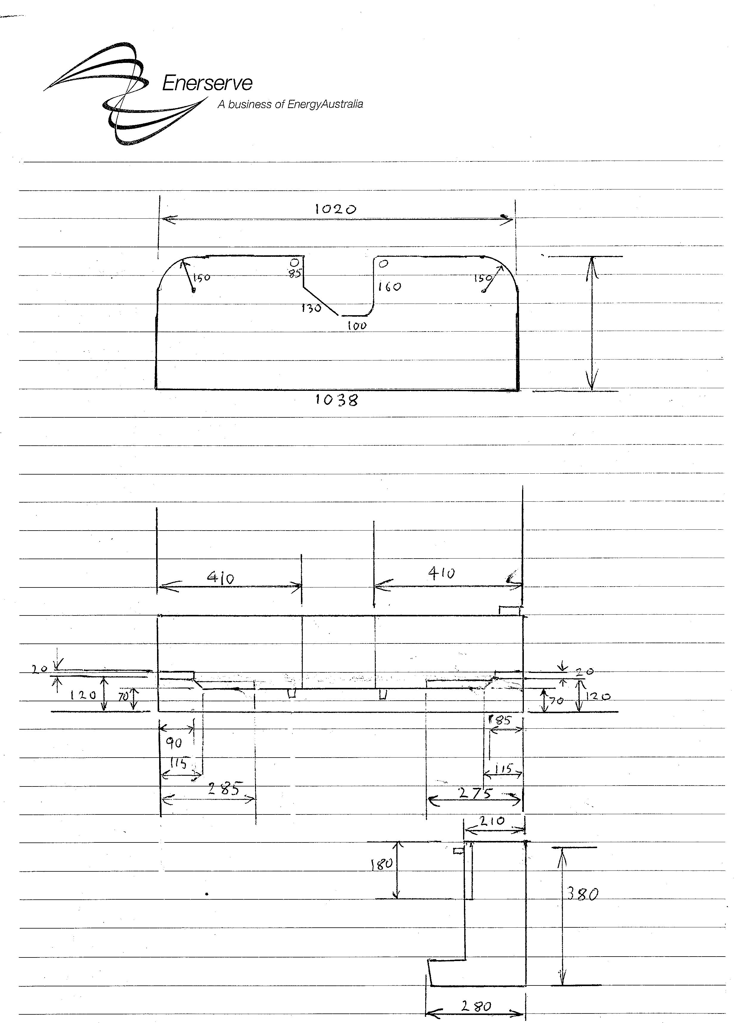

Will,
Here is a sketch of my fuel tank with some dimensions, sorry about the
metric dimensions, all my rulers are metric, hope this helps.
Cheers,
Brian Phillips

 Filesize:  583.6 KB
 Viewed:  10280 Time(s)
