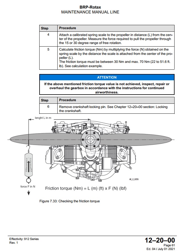

Question for folks: what typical pull values are folks seeing for their gearbox dog friction measurement? I'm near the low limit of 22ft-lbs.

Hi Pete On our 914 circa 2005 which is new and only run at factory, I pulled the gearbox to inspect things and purged oil system and got oil pressure. Engine was at room temp with Mobil 1 10w30 oil. It also has a B&C SD20S alternator on the vacuum pad which definitely adds to friction. I measured January 284.4 inch lbs., or 17.8 foot lbs.
Maximum allowable friction is 1,328 inch lbs., or 83 foot lbs., so I was just about 22% allowable. Ron P.

My bad I wasn't clear enough.... I was speaking of the locked-crankshaft dog-clutch friction test as per the pic of the Line maintenance manual attached.
I am very near the minimum torque spec (22-51.6ft-lbs), with a freshly serviced (by the local authorized rotax center) box.... discouraging.
I was wondering what other folks are seeing typically.... ie - near the bottom as well? Or nicely centered in the range (and (at) how many hours).

I looked at the last couple years of inspections and found that our 914 shows about 35 ft lbs. We measure with a cheap fish scale so accuracy is not real high but reasonable.
