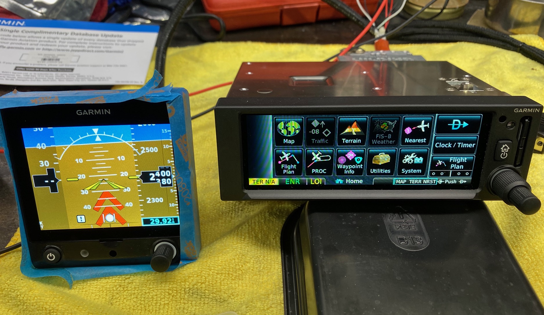

Work continues on the panel upgrade. Finished the wiring harness and powered up the G5 and GPS175.
No smoke which is always a good sign. However, it appear that the G5 isn’t seeing the GAD29 (ARINC 429) as it is grayed out on the setup page. So, the G5 and GPS175 aren’t communicating.
Funny thing is, I am not getting any errors on the CAN bus. The GAD29 has a flashing green light which means it is communicating with the G5 on the CAN bus.
Any suggestions as to what the issue is or a fix are welcome.
