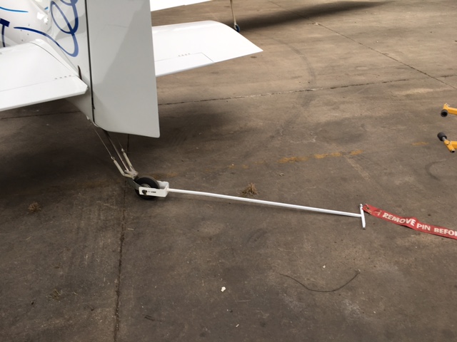

alan.twigg775(at)gmail.co
PostPosted: Mon Jul 12, 2021 3:03 am    Post subject: Europa tail wheel tow bar Reply with quote
This is what I use.
Alan Twigg G-GIWT
