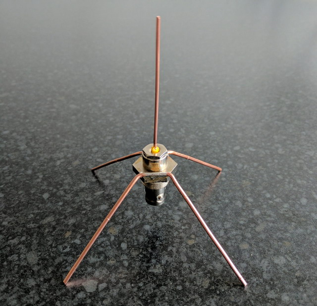

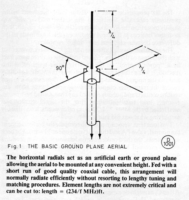

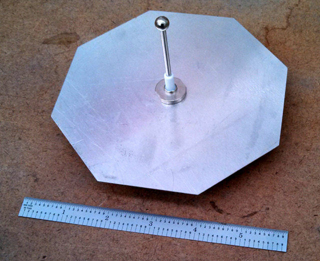

At a hammer-n-tongs level I like to envision
ground planes from two perspectives. The common
terrestrial version utilizes what I would
call a 'resonant' ground plane.
The goal of a ground plane is to
provide a minimal loss (lowest practical
metallic resistance) non-radiating
conductor to concentrate radiation
energy in the vertical element.
Consider a vertical dipole antenna with
a feedline attached to the center. You
have two elements in the same plane
that share energy management tasks for
emitting and receiving energy.
Now, fold the bottom element 90 degrees
to horizontal. Intuitively, one can see
that this element is now in vigorous argument
with the vertical element for squirting
energy off into the ether.
Each element has a load impedance on the order
of 30 ohms. Suppose we added a second horizontal
element opposite the first. Now we have TWO
radiating elements with a combined load impedance
of 15 ohms . . . now we can calculate that
energy fed to the base will have a 15:30 division
ratio with most of energy going to the 'good
guy'.
Okay, let's add two more radials elements disposed
90 degrees from the first two. Now we have a
load impedance of 30/4 or 7.5 ohms for the
combination of bad guys . . . and 80% of the
energy at the end of the feedline goes to the
'good guy'. 4-radials is a practical place to
stop adding . . . the difference between 80
and 100% of energy going to the 'good guy' is
not observable in practice.
But we don't need to stop there. If you droop
the radials at about 45 degrees, you increase
the theoretical feed point impedance of 30
ohms (close but not quite 1:1 swr for 50
ohm feedline) the match is a bit better and
one of several potential losses in the system
is reduced. Drooping also reduces the radiation
angle of the antenna so as to focus more attention
at the horizon as opposed to the Andromeda
galaxy.
On the other hand, you can add an infinite number
of radials forming a solid disk. Now the theoretical
load impedance of the plane approaches zero
ohms . . . a good thing you can do to improve
performance.
Now, here comes those pesky machines known as
airplanes . . . with envelopes and structures
that are not very friendly for seeking an
optimal antenna installation.
In a plastic airplane, you can choose to go the
enhanced or optimized route for achieving a
suitable ground plane. At ADSB/XPNDR frequencies
the optimized route is pretty easy. The disk
is relatively small. At VHF frequencies, the disk
is unmanageably larger so optimization with
4 or more 'radials' becomes the technique of
choice.
The short answer is that mounting antennas
on the outside of a metal airplane offers
a perfectly satisfactory ground plane although
the infinite number of radials are not resonant.
No big deal. In a plastic airplane, the ground
plane needs to be fabricated and going the
resonant mode with either a disk (optimal)
or radials (enhanced) works good, last a long time.
