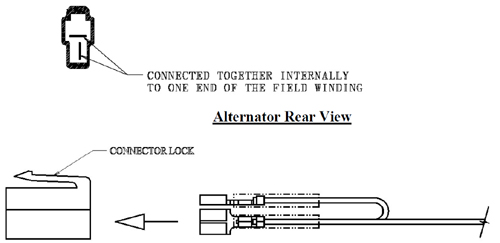

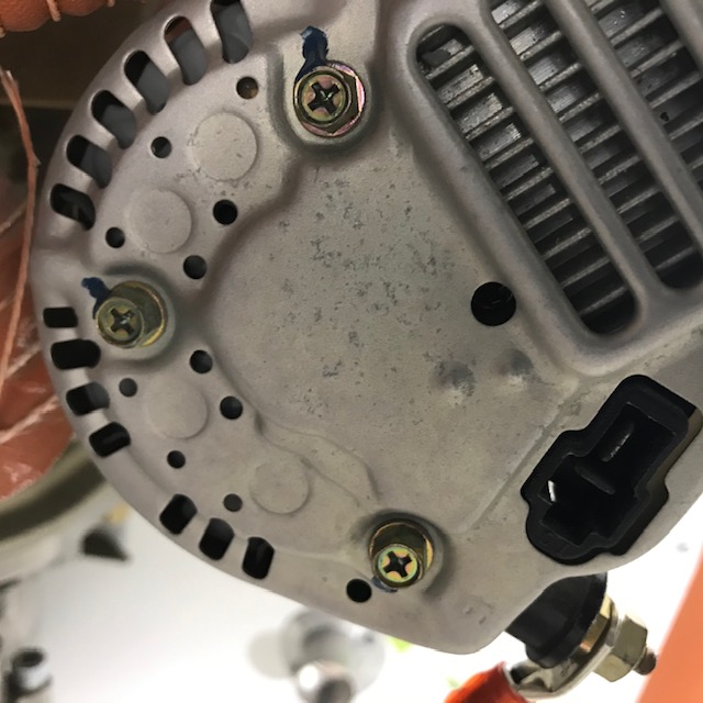

Interesting. I had simultaneously contacted Continental (It's an IO550), and they said to run a ground wire from a screw holding the (??alternator brush"") to the case. But if the alternator is already grounded via attachment to the case, why would that be needed? They did not mention grounding the second field terminal to the case. So now I'm confused Sad
Separately, the SD20 backup alternator field also has two leads and it takes a connector that I either lost or was not supplied with the alternator. (See attached pic). Anyone know where I can get that two lead connector? Maybe an auto parts shop? And does one of those wires ground to the alternator case?

PostPosted: Sun Jan 17, 2021 10:14 am    Post subject: Alternator Ground Reply with quote
At 09:29 PM 1/16/2021, you wrote:
--> AeroElectric-List message posted by: "rparigoris" <rparigor(at)hotmail.com>
Hi AdventureD For SD20 connector:
https://bandc.com/product/replacement-field-connector-for-alternators-l-40-bc410-h-bc425-1-sk35-lom30/
as far as field wires, they are to be paralleled to regulator.
There is only ONE wire from the field
connector to the regulator on B&C wound-
field alternators.
These are automotive conversions where
two of the original terminals on the back
were control and warning light connections.
The conversion process removes the stock
regulator and they used to tie ALL pins
of the rear end bell connector together
such that any one would suffice as a field
connection. The are always configured to
operate as B-circuit fields (one brush
grounded inside).
I have a SD20S and just twisted 2 wires together from regulator to go to
both field wires. One is not a ground. You can just make a short paralleled
wire as well.
Twisted wires? You lost me there.
Here's install manual: https://bandc.com/wp-content/uploads/2018/05/install-instructions-bc410_revC.pdf
Okay, yeah. Instructions call for tying
both pins in the connector together with
a jumper at the plug . . . this is for
redundancy in the fast-on terminals. One
wire from alternator field to regulator
suffices.

As far as grounding for SD20, it's grounded by the 4 mounting nuts. I'm going
the belt and suspenders route and running an extra ground from one of the
screws on the brush side of case to engine ground.
For what purpose? The resistance between
components of the assembled case is measured
in micro-ohms . . . a milli-ohm jumper around
these joints is of no electrical value.
Hedge against what other condition . . . mechanical
looseness that disconnects the end bell from the
rest of the alternator? Those fasteners are
like prop bolts and strut attachments. I.e.
at the very bottom of risk levels in a reliability
study.
Manual tells you torque value for B+ nut. Best not ighten to
the old stand by of stripping and backing off 1/2 turn!
Never heard of such a practice. The physics of
achieving the required make up forces by measuring
the tightening force on a threaded fastener
is quite clear. Backing off any fastener after
achieving the specified tightening torque has
no obvious merit.
