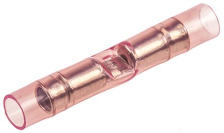

A couple of questions on this connection. Z101 calls for a 12-gauge FLW butt spliced onto the 10-gauge main alt B-lead wire.
I didn't see any this large at Spruce, but it appears that both Amazon & AutoZone have the Dorman splices in 8 gauge. Is this a satsifactory product for our needs?
https://www.autozone.com/miscellaneous-non-automotive/electrical-wire-connector/dorman-conduct-tite-8-gauge-butt-connectors/422502_0_0
Also, are there any special techniques required to ensure that the smaller wire is propertly gripped in the slice when crimped? Do I need to put some extra wire strands in there to fill the connector & snip off any excess?
Thanks!
David

PostPosted: Fri Sep 25, 2020 8:04 am    Post subject: Butt Splice on Main Alt B Lead Reply with quote
David,
I classify those kind of connectors as "cheap automotive" wire terminals and would not recommend them for use is aircraft.
Do a search for AMP (is Manufacturer) PIDG (Pre Insulated Diamond Grip) butt splice for something that looks like this:

PostPosted: Fri Sep 25, 2020 8:22 am    Post subject: Butt Splice on Main Alt B Lead Reply with quote
At 09:56 AM 9/25/2020, you wrote:
A couple of questions on this connection. Z101 calls for a 12-gauge FLW butt spliced onto the 10-gauge main alt B-lead wire.Â
There should be a 4AWG spread between the protected feeder
and the fusible link stock. So the 10AWG feeder from the aux
alternator gets a 14AWG FLW. That's the case in the
last iteration of Z101 (rev B).
I didn't see any this large at Spruce, but it appears that both Amazon & AutoZone have the Dorman splices in 8 gauge. Is this a satsifactory product for our needs?Â
The 'yellow' series PIDG terminals are indicated
for 10-12AWG wires.
https://tinyurl.com/y4njsbmt
This splice would work with our favorite po' boy's
crimp tool.
Keep in mind that 'gas tightness' of the interface
between wire and splice is the holy-grail. Folks
like AMP, Molex, C-H, have spent untold bux researching
and qualifying proven combinations of crimp dies, terminals
and wire stranding to achieve those goals.
Now comes wire, terminals and tools from a variety of
sources NOT tested for playing nice in the same
sandbox. Here are some references from the
'Connection
https://tinyurl.com/kfk6jss
http://aeroelectric.com/articles/terminal.pdf
Field history on this series of tools with PIDG has
been favorable
https://tinyurl.com/yy6wlbv2
You might look into this alternative. The heat-shrink
terminals and butt splices have been around for awhile
https://tinyurl.com/y26la2p6
. . . but no tools that produced a elegant upset of the
wire grips without mangling the insulation . . . until
now.
https://tinyurl.com/y3kzobsx
I'm ordering one of these in to take a look and try
it out.
You betcha. Strip the 14AWG wire back about 1/2
and fold it so as to double the strands
in the wire grip.
Alternatively, you could consider a soldered lap
joint like this
https://tinyurl.com/yxq7c5d9
BUT NO MATER WHICH TECHNIQUE YOU CHOSE TO EXPLORE,
BUY EXTRA TERMINALS AND EXPERIMENT WITH THE
PROPOSED TOOL(S) AND WIRE. DO A PULL TEST TO INSURE
THAT YOUR WIRE/TOOL/TERMINAL COMBINATIONS ARE
COMING TOGETHER IN BLISSFUL EMBRACE.

PostPosted: Fri Sep 25, 2020 8:52 am    Post subject: Butt Splice on Main Alt B Lead Reply with quote
Aircraft Spruce # 320570

Mauledriver(at)nc.rr.com
PostPosted: Fri Sep 25, 2020 9:03 am    Post subject: Butt Splice on Main Alt B Lead Reply with quote
You would need crimping equipment of the right size in order to use a crimp type splice.  Even assuming a quality connector is available, doing it once or twice may not justify getting the crimping equipment required or gaining the practice needed to do it 100% effectively.
I'd suggest a solder type butt connector sized for 10guage and then stuffing the 12 guage side with extra strands as required.  All you need is solder and a torch to get it done.  Big item like that is easier technique-wise than smaller solder work.

jluckey(at)pacbell.net
PostPosted: Fri Sep 25, 2020 11:15 am    Post subject: Butt Splice on Main Alt B Lead Reply with quote
David,
See if this meets your needs....
Heat Shrink, Crimp Seal Butt Connectors
<![endif]--><![endif]-->$7.73
<![endif]-->Heat Shrink, Crimp Seal Butt Connectors

PostPosted: Fri Sep 25, 2020 11:31 am    Post subject: Butt Splice on Main Alt B Lead Reply with quote
At 11:41 AM 9/25/2020, you wrote:
I made a mistake in my question. The main alt  lead is 8 gauge & joins to a 12 gauge fusible link.Â
That's the size butt connector I'm not seeing at Spruce. The yellow amp goes up to 10. Â
Crimp tools in that size are not commonly
available. I think I'd go for a soldered lap-joint
for that one.

PostPosted: Fri Sep 25, 2020 1:03 pm    Post subject: Butt Splice on Main Alt B Lead Reply with quote
Yes, I was leaning toward the soldered lap joint approach. I considered crimping ring terminals on each wire end & joining them with a 1/4" bolt/nut assembly, but the 8-gauge crimper again becomes a problem.
Thanks to all for the advice & ideas.
 for that one.

Don’t know if these butt connectors would be of use here, but I am curious what Bob thinks.  This URL goes to a Summit Racing site and shows that application.  Looks pretty slick to me.
https://tinyurl.com/y374wd4m
