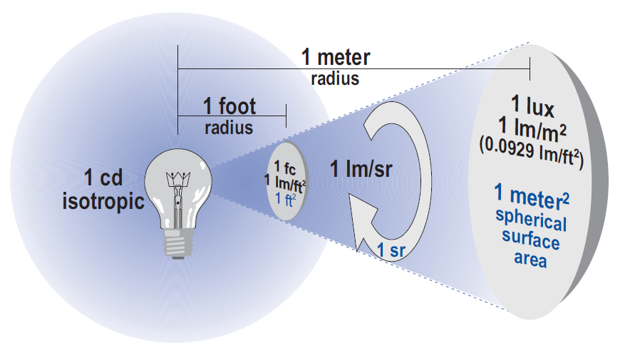

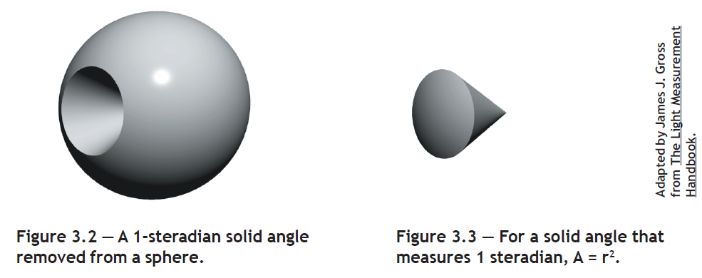

Light ratings need explicit definition as they involve a number of variables as white light is defined in five dimensions.  The old watts rating along with is it a "bare bulb", a "flood" or a "spot" used to be good enough as these are all white black body radiators.
The link you provided has a conversion of radiant flux to luminous flux.  The wattage on filament bulb ratings is the input power, no direct relation to radiant flux.
Lumens describe luminous flux,  Simply how bright the source appears to the human eye.
Lux is unit of how much of that brightness will appear on a surface at a defined distance.  One lux = 1 lumen per square meter at one meter distant from the source.   1 footcandle = one lumen per square foot at one foot distant from the source.
1 candela = one lumen per steradian. (see below)
[img]cid:ii_ke8u4wr70[/img][img]cid:ii_ke8u6du11[/img]
White LEDs are typically rated in CD (candela) or Lm  (lumens) for radiant output..  They are also specified by CCT,  (correlated color temperature).  Roughly 5000°K = daylight,  2500°K= candle light (yellow/orange).  As CCT is a one dimensional characteristic which works well for a filament source it can produce very different results for an LED which is a cold light source.  The applicable color characteristic for LEDs is "chromaticity".
If all this is confusing it is because light is electromagnetic radiation and as such is multidimensional.
If anyone is interested I will provide my slide deck to my course "Intro to Illumination" course.  Contact me at chris dot stone(at)a-dec dot com.  (replace the "dot" with a .) to elude spammers.
[img]cid:part1.599BE7D6.D2076DA8(at)gmail.com[/img][img]cid:part2.9BDA031F.B394058E(at)gmail.com[/img]
.chris stone
to radiant flux.
the human eye.
[image: image.png][image: image.png]
is "chromaticity".
.chris stone
