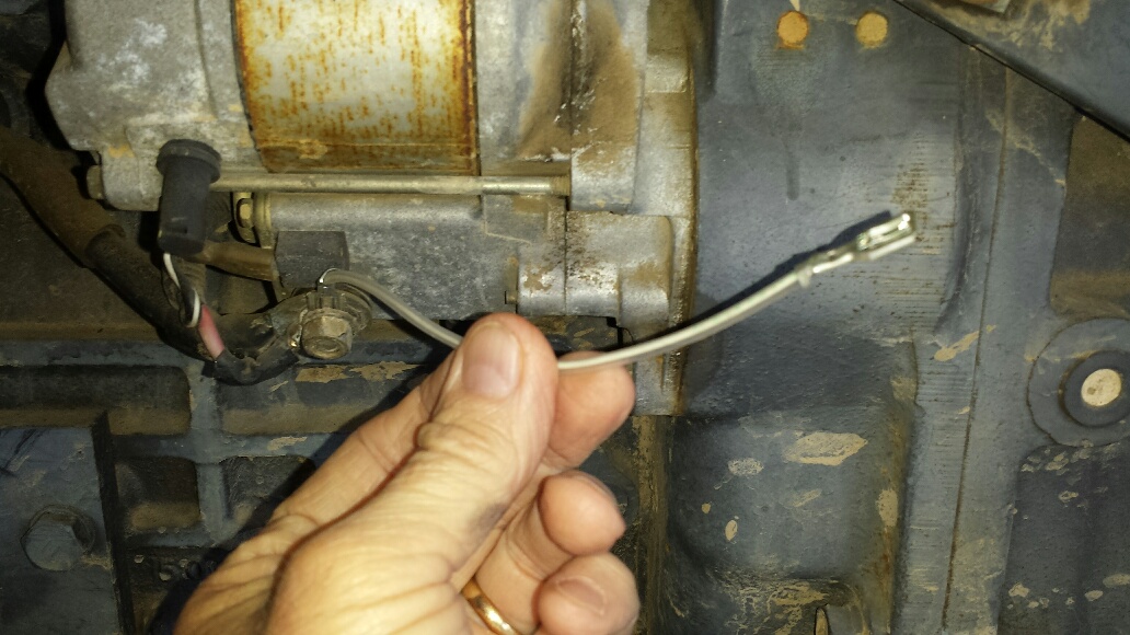

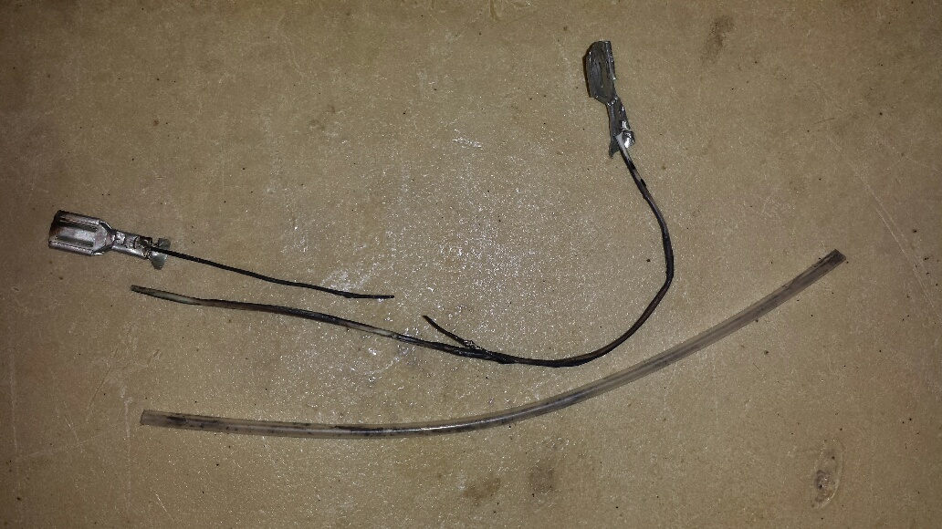

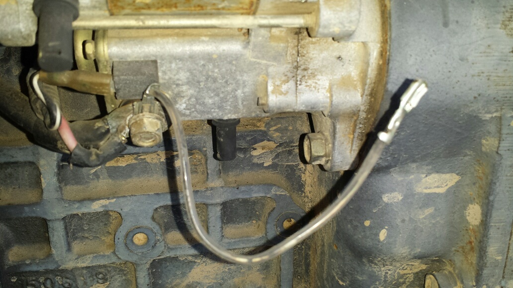

Reasonable question; might have been driven by 'off-the-shelf' fusible link size availability. 22awg (minimum reasonable size to work with) link (sleeved with silicone tubing) to 18awg would get the job done. 20awg after the breaker because the breaker protects it.
I've tested the silicone tubing trick on 22awg with a direct short on a 12v tractor battery. The wire vaporizes, leaving a smoky interior lining on the clear silicone tubing, but the tubing contained the 'event'.
