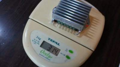

I put a lipo battery in my Europa...for better results I change my regulator by a Silent Hektik. Like this: https://www.silent-hektik.de/UL_R_912.htm

Unfortunately, Silent Hektik refuses to sell their items to UK residents. Perhaps a reaction to Brexit - But they didn’t give me an explanation!

PostPosted: Tue Apr 14, 2020 11:49 am    Post subject: Batteries Reply with quote
Hi Richard,
My building buddy has a Silent Hektik for sale. He might be willing to send it to you (regardless of Brexit or else Wink.
Sorry, only picture I have :
[img]cid:part1.18ECAFFF.A40B68BC(at)elixir-aircraft.com[/img]
If interested, do not hesitate to pm me.
FWIW
