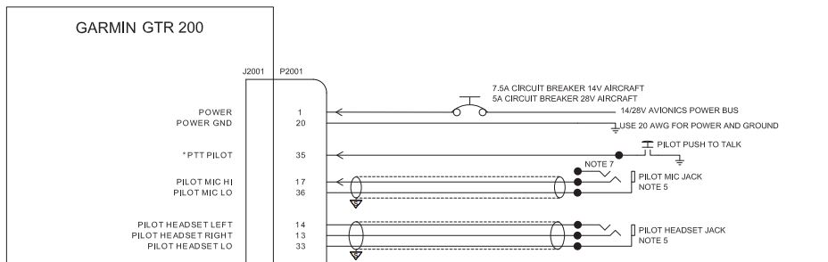

Hello all,
I'm sure this has been answered before, but I'm planning to use two com radios without an audio panel, so I need to switch the mic input. My current plan is to use two PTT switches on the stick, and tie the COM 2 PTT to a relay to switch the mic automatically. Does only the "MIC HIGH" side need to be switched, or do I need to switch the "MIC LO" side as well? I think "MIC LO" is just a ground reference for the mic input, but I'm looking for the lowest noise solution.

Thanks for the answers. Not switching at all would cause an impedance mismatch in my case as both radios have a built-in intercom so the mic input would always be live. Sounds like switching the MIC HI line is the way to go.

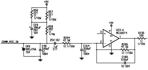

PostPosted: Thu Mar 12, 2020 1:04 pm    Post subject: Two coms mic switching Reply with quote
Most audio circuits are a low impedance feeding a high impedance, but you can't assume it's
true in every case. You may well find high gain inputs that have their load impedance
intentionally kept low, to reduce noise susceptibility when there's no source connected.
Keep in mind that the MIC HI input to an intercom
or transmitter is designed to interface with a
powered, amplified microphone. This is a legacy
hold-over from the days when aircraft microphones
were not unlike those in your telephone . . .
carbon granules behind a foil diaphragm.
https://tinyurl.com/htnn6nq
This microphone is essentially a resistor whose
resistance varies with audio stimulation. Hence
it must first be biased up with some current
so that the electronics can tap the resulting
voltage variances that represent speech.
Here's an exemplar MIC input circuit for a
King transceiver . . .
[img]cid:.0[/img]
Looking into the DC power path, the DC source
impedance is on the order of 600 ohms, the AC
load impedance is on the order of 390 ohms
while the load impedance of the first audio
stage is about 48,000 ohms.
So while the voltage INPUT network may indeed
be 'high' impedance, the microphone BIAS network
is not. Further, paralleling two such inputs
doubles the bias to any one microphone.
The using DPDT "TX SELECT" switch for PTT and
MIC HI lines is pretty much mandatory.
